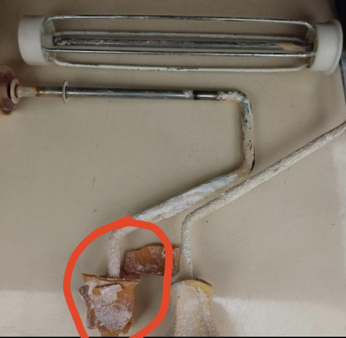

Me personally like Stanley more compared other due to personal preference
I personally ordered 9 inch common size widely available 7 inch also personal preference
Cheap one time use most of the time the roller the fabric very easy fallout during brushing and also thinner not great absorbing paint
Better one usually thinkers fabric, very good absorbing paint can apply larger surface in one go yet still depends your skill
Left side is cheaper brand after 5 year sendiri dissolve and cracked just noticed
Right side from 9 inch b2b order from Stanley everything still intact still usable only need the roller
Cheap punya you can use for solvent base paint if one time use since no one really notice if the fabric from brush stick to the pagar something
Then before applying new paint remember resurface, remove the cracked pain, make the surface smoother, applying primer if needed, or base coat like maxilite then only paint the colors your want then also let the paint time to dry before applying 2nd layer and so on,
At the end depends your skill
Good luck have fun

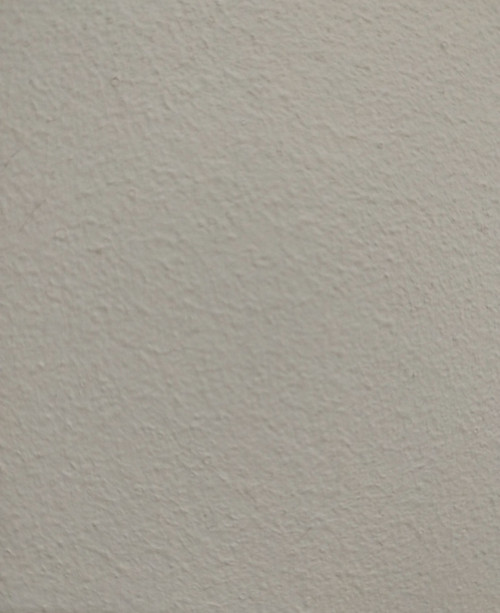

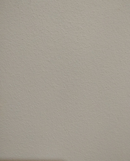

Roller fine and rough yes is important but still depends the surface, i mean if surface is rough cement texture outdoor always rougher than indoor, i believe your current indoor surface if you look closely can notice the texture unless your wall is very smooth, if you only applying new coat to exiting coat the texture still there i believe
To me Very fine roller or brush usually focusing on wood for wall i don't think is too much important because i not always go and touch the wall compared the wood table i every day sit and use and feel just my opinion
To me i want the roller absorb more paint probably I'm experience can knowing how to control and the roller some model come with line can telling me if the roller is skipping or how fast is rolling indicator or due to too much pressure, to much paint, the paint is too thin/thick etc indicator or leaving a tail due to either left or right applying too much pressure etc

I taken 2 photo one is closer look the other is slightly behind look sorry due to privacy i can't take the whole wall pictures, but the texture is from the rougher roller i use from Stanley and I think the texture is very nice just probably the color from my phone camera very CB 😂

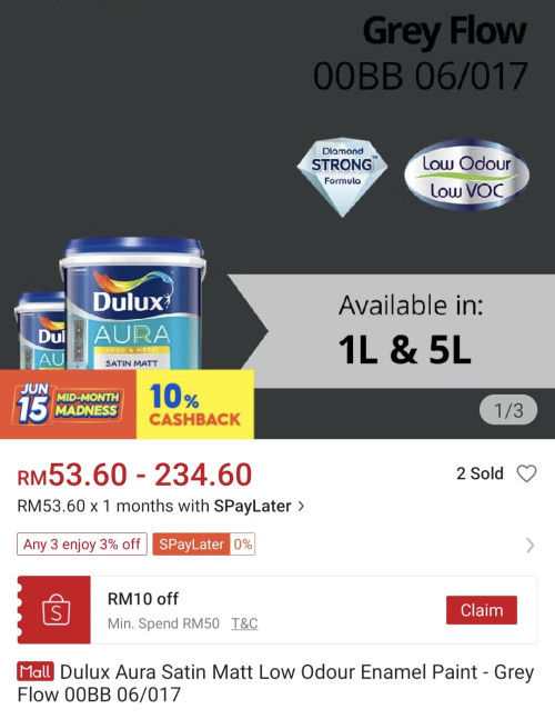

do u have any paint to intro for metal / wood ? or actually those water base paint can actually paint on wood / metal too?
and would u like to intro the matte type , because i do see nippon 9000 metal/wood is glossy

I don't have experience with matt paint but you can try search for matt enamel paint for metal/wood for more references
This post has been edited by zuozi: Jun 19 2024, 11:54 AM
zuozi
post Jun 19 2024, 01:45 PM
1,267 posts
Joined: Oct 2009
QUOTE(chongkiatz @ Jun 19 2024, 11:38 AM)
I searched online and shopee actually quite a lot of options for matt enamel paint including some local brand , specifications suitable mostly all surface including outdoor, as long surface requirements and preparation is smooth whatever paint go for it also very beautiful

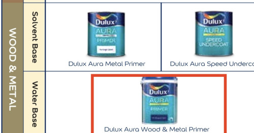

so for metal / wood paint doesnt neccesary to be oil base , water base also can be painting?
zuozi
post Jun 19 2024, 07:11 PM
1,267 posts
Joined: Oct 2009
QUOTE(chongkiatz @ Jun 19 2024, 05:16 PM)
Yes but you need follow their specifications and requirements , the surface treatment and preparation you need to do it properly.
Example their requirements only needed the primer and based coat but from my experience they didn't tell the whole story how to do it properly
Water based primer properties according to Dulux
High quality water-based primer
- Suitable for use on a wide variety of substrate, including metal and wood
- Specially formulated primer provides good adhesion on wood and metal without the strong odour of solvent based primer
- Rust prevention properties
- Good adhesion properties
- Conforms to Singapore Green label criteria
- Colour: White only
This post has been edited by zuozi: Jun 19 2024, 07:21 PM

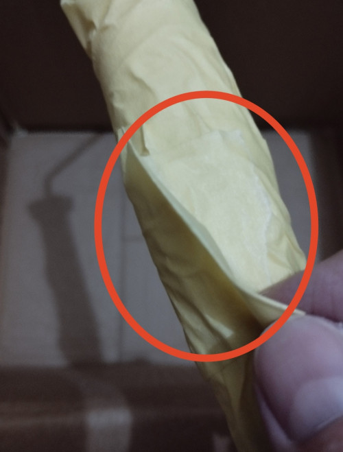

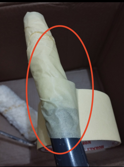

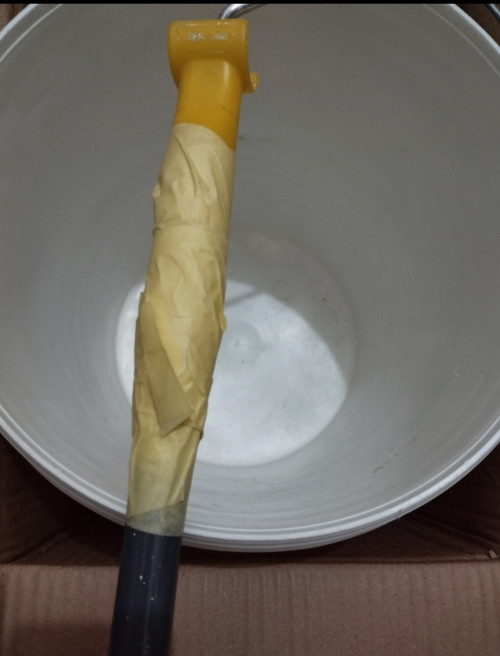

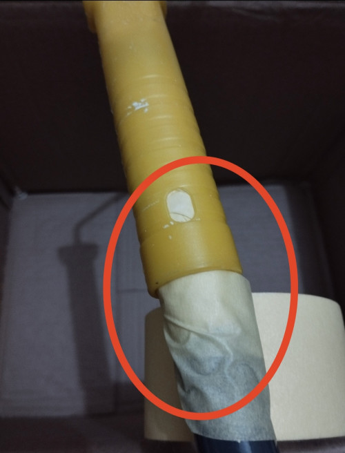

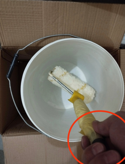

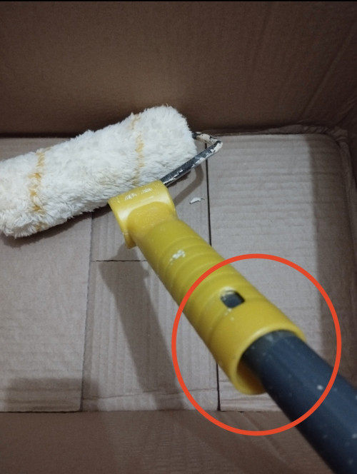

Not sure how experience you are but since you really into it maybe i can give you some entry level advice, most paint guy don't use paint tray collector mostly use bucket only, hope the technique make your life easier
Just remember the surface preparation do it properly before painting, i mean paint is expensive, labor and time also expensive do it one ago properly and puas hati 😂 😂
Sometimes is hard to find a perfect stick and fit, especially if you drill a hole to secure it eventually loosening or crack for wood eventually the wood become shorter then got to unscrew etc is annoying for us
Instead i use white paper tape wrap until specific thickness then stop don't tearing off the white paper tape yet
Then squeezing in all the way to the roller housing should be tight fit and very secure no moment left or right or up and down at all if loosen pull out and wrap few more round white paper tape
Now wrap the roller and stick together like 10 to 20 pull and tight round up and down until secure and make a marking for you to peel off later after use
Now the roller should be look like this very secure won't be loosen for whole day no matter how just for painting purpose 😄

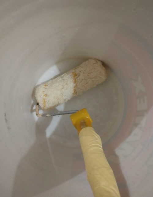

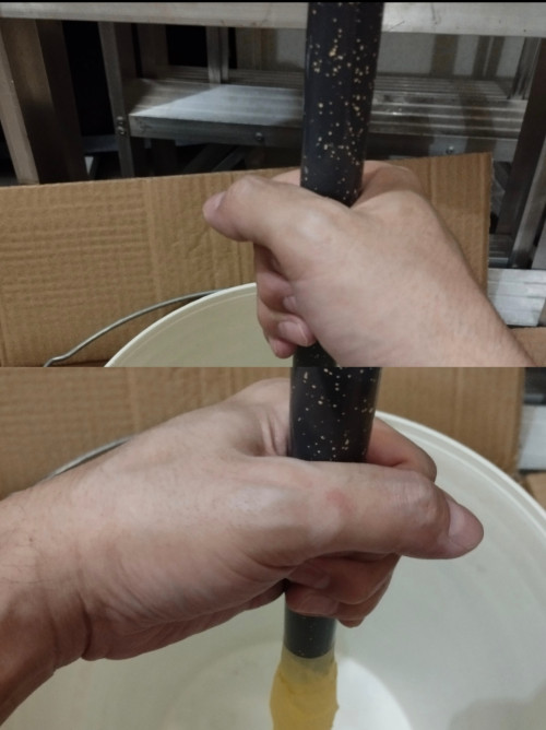

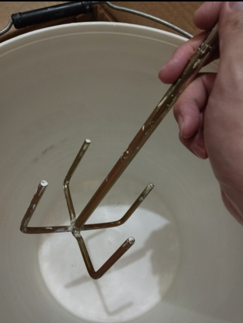

Pour half wall paint into empty bucket dip all the way in fully submerged and covered don't worry the white tape getting wet trust me won't falling out
Then raise the roller to mid air within the bucket and holding position something like my red circle and give it a good and fast counter clockwise spin the exceed paint should be spreading all over the bucket wall
Or if the paint stick is long then you can use both hand to grab like picture showing, left hand for hold right hand give a good and fast counter clockwise spin then release and your left hand should be able to hold it and prevent the roller drop to bottom or entirely only right hand is needed to quick spin, release, grab, throwing up little and repeat spin, release, grab movement if you get the idea 😉
Paint mixer you can using bare hand and stick to mix evenly after thinner with water or grab and hold the entire paint bucket and shake for 18 liter quite impossible or you can get a universal paint mixer compatible with all drill power tools

During spin off the exceed paint roller can hit the bucket side wall with annoying sound if can't holding in center position don't worry about that , just give it a spin few time until the paint is no more raining then only you brush the wall ,
brushing wall got paint line faster faster make a correction from your roller by reducing the pressure up and down and left and right spreading the paint evenly
If wall height 9 feet the bucket roller one dipping paint usually enough for 3 roller section if roller width is 7+7+7 on wall as a measurement example, once this section is evenly coated sometimes got light spot or darker spot ignore it, dip new paint go to new section, the previous section give the wall have time to dry or dry to touch usually 1 or 2 hour only you apply 2nd coat much more easy stick to it after is dry if too wet you keep brushing the results also same won't help, remember give time to dry
Other than that Brushing skills depends your talent liao here is hard for me to teach Liao just by typing long wall of text 😂 so good luck have fun.
