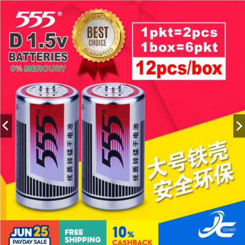

Thanks for all the replies to my post and I had found the battery that works for my gas hob with the electron spark similar to the battery that came with the gas hob.
