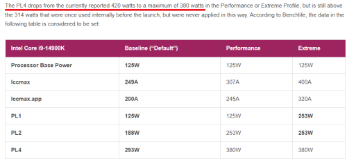

Modern CPUS both Intel & AMD, will boost until it reaches certain limits whether its TDP, or PL limit, or temps, whichever comes last. In your case, if you had set to PL unlimited (or 4096W) then your CPU actually pulling power waayyy past its PL2 limit (253W) in fact into the previously unknown Extreme profile PL4 limit (420W)
This is actually not good as it will fast degrade the CPU, you should update the BIOS which defines the new “Intel Default Settings”
https://www.igorslab.de/en/intel-spielt-mit...fault-settings/
Even then I still reco to manually set PL2 boost limit to 253W just to be safe. You wont get as high that impressive 37k score in R23 but your CPU will last much longer.

Indeed, do another R23 bench and see the max TDP load. It should drop down to 380/253W

It should not have turboed past Default limit with latest updates hmm.gif Did you do anything to PL2 limit in bios?

Everything is default. Not even XMP is enabled. Didn't find any option to enable Intel default profile as well.

The problem is, 'default' may not be default as you see from that Jay2cents vid you posted. You may still have to go into Bios and manually set the PL2 TDP limit.

jangan kasi set pada motherboard default atau auto,
kasi kawal tdp ke intel spec 253w,
