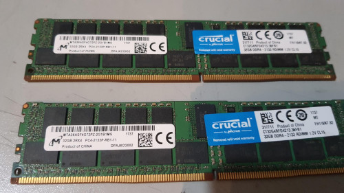

Hi. I just recently had in hand 2 sticks of 32GB DDR4-2133 RDIMM Ram
I've tried them on my pc running with X570 motherboard and R9 3900x but didn't manage to boot up. I guess not compatible even though the motherboard support ECC rams.
Since they are not easy to get, so i guess will try to see what i can do with them before letting go.
I really appreciate for any suggestion for best pc or workstation setup that i can come out with with these rams within the budget around 3-3.5k.
I mostly do 3d modelling and rendering.
Maybe can start with motherboard which maybe compatible. I've been searching around but mostly support EEC UDIMM.
Thanks in advance.

Just sell them wink.gif The component cost to drive them is too expensive.
Motherboard vendor doesn't spend time to add the support on consumer level board since normal user doesn't need it. So your choice is either :
- Decommissioned server -> You don't get modern single core performance
- HEDT -> Will experience some performance lost at the 2133MHz and cost ridiculously high that doesn't really justify for such purpose.

RDIMM is in Epyc territory, no way would be cheap. With such niche Im also doubtful there will be much demand in 2nd hand market, even tho these stuff are not cheap when new. Good luck!

I have made a price check on server parts before, I found some used parts on taobao that can support Registered ECC Ram, eg
- Xeon Gold 6133 with SM X11SPL-F for RMB4100
- Xeon E5-2680v4 with SM X10SRL-F for RMB3400
- EPYC 7xx2 wiht H12SSL-i for RMB5550
- a stick of 32GB registered ECC ram costs RMB200-300
The cheaper option would be going with older Intel Xeon platform, but they would be less efficient. EPYC platform is powerful, gives you lots of cores and PCIE slots but the price is crazy.
The cost to upgrade to these server grade parts are huge. Often need to swap the entire system. Then you need to factor in the total power consumption, electricity cost and heat & noise if you want it to run 24/7.

I believe ddr4 registered rams work on X99 systems. just pair with some affordable xeon and a old x99 mobo

Thank you for all the response icon_rolleyes.gif icon_rolleyes.gif . I've done some searching and found used X99 motherboard as suggested. Gonna use the setup for 3d modelling, pairing with my old GTX 1080. Should run well for the task i guess. Not going to use for gaming.
