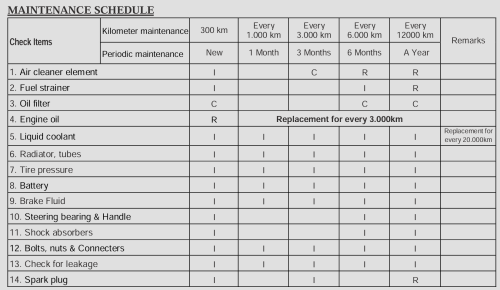

first time hear that no oil filter. if u refer maintenance manual booklet, there is oil filter location. it is even stated in the maintenance schedule.
https://sym.mforce.my/img/product/SYM/VF3i1...30727092754.pdf
This post has been edited by Netto Hikari: Apr 18 2024, 02:46 PM
TSaccordvtec
post Apr 18 2024, 04:40 PM
107 posts
Joined: Jul 2021
QUOTE(Netto Hikari @ Apr 18 2024, 02:45 PM)
ive clarified with my pomen, he said no replacement filtrate which is normally disposable. only for cleaning just like stated in the manual
