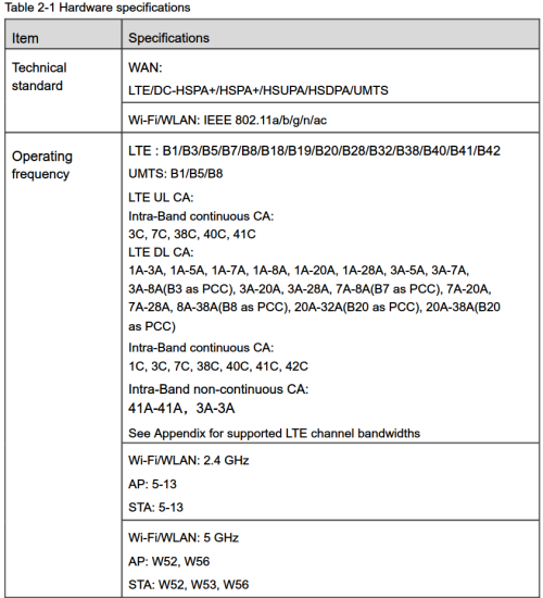

JLA
post Dec 23 2024, 10:00 AM
2,792 posts
QUOTE(my44 @ Dec 21 2024, 05:19 PM)
All those 5G modems are too big for my use case (need to move between a few houses). So far I see LTE modems are reasonably small as long as I find a good spec like 2CA or 3CA.
Also, no offense yeah, this is 4G/LTE modem thread?
E5785-320 4G+ LTE MiFi Modem Router 300Mbps
4G Transmission Rate
Max. DL:300 Mbps
Max. UL:100 Mbps
Theoretical value. The actual rate varies with the operator, network conditions, distance, and terminal type.
my44
post Dec 23 2024, 08:07 PM
2,492 posts
From: Cheras
QUOTE(JLA @ Dec 23 2024, 10:00 AM)
Max. DL:300 Mbps
Max. UL:100 Mbps
Looks interesting. These few months I’m experimenting with Yes4G and B20+38 maybe can increase the performance a bit. Obviously I’m not looking for 5G solution yet (those 5G ‘mifi’ still quite out of my budget).
