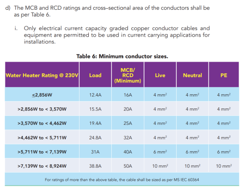

usually no need to brake tiles. just pull the wires through the pvc hose
should use 4mm2 cables. (my mistake. should not be 2.5)
https://www.st.gov.my/en/contents/publicati...r%20Systems.pdf
you may read the guide cover to cover.
some points
- use double pole 20A water heater switch
- as much as possible, the LN wires should not have joints.
- earth cable should not have joints.
- do not use 3pin plug to connect water heater
- leave a loop of wire before entering water heater (so water wont go inside)

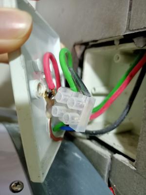

Damn, my electrician put 3 pin plug for the water heater when we did whole house reno.
Yeah usage of 3-pin socket + plug connection to power up water heater is a BIG NO for water heater, according to Suruhanjaya Tenaga guideline.
U can either
a. get the contractor to remove the 3-pin socket and its junction box and connect the electrical cable directly to the water heater, which u might need to hack some walls to hide the cable and to fill / cover the hole left from the removal of the junction box, or
b. a cheaper and faster option is just to replace the 3-pin socket with a water heater connector (shown below) while reusing the 3-pin socket's junction box, so no hacking or filling holes required. U can easily purchase the water heater connector online - Shopee / Lazada

QUOTE(ivan89 @ Jan 26 2024, 02:16 AM)
Understood, thanks lj0000, ceo684 and Selene Yeo for the advice!! Sorry for late reply, was busy juggling work and renovation.
The contractor basically just pushed the blame on his staff. Excuse is 2.5mm finished, so his staff used 1.5mm. Quite BS la.
I warned him to be more careful and professional.
By the way, I've also decided to change completely new wiring for the common bathroom's water heater from DB too.
I bought Mega 4mm wire for the contractor to use this time.
The (instant) water heater I bought is Deka 4.5kW high power version.
For the RCBO, I bought Schneider Easy9 25A, 1P+N, 6kA, C Curve 10mA.
Schneider RCBO somehow doesn't have 20A version.
1) Should I buy EPS 20A 2P 10mA 6kA RCBO Type AC instead?
25a is ok
4500/230=20amps already
2) Why EPS RCBO has 2 poles, while Schneider RCBO only has 1 pole?
Rcbo need to compare live and neutral
Mcb only measure the live.
3) Is RCBO only good enough? Or should I use MCB + RCCB setup?
Rcbo save space. It's only 1din size. so ya it's good idea to use rcbo. Drawback is, if fail then harder to buy and more expensive compare to separate mcb+rcd.
There are debates that voltage based rcbo should be used. When tnb voltage is low then the current sensing won't work, that should not happen for domestic lah
Thank you all again!!

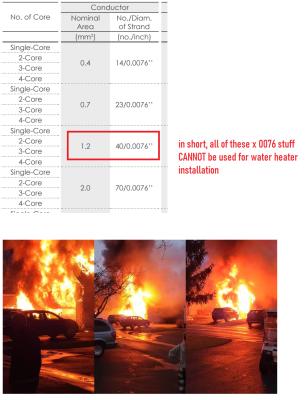

With 4mm cable the RCBO you have is sufficient.
Just to show what happens when 1.2mmsq (40x0076) is used on a WH:
