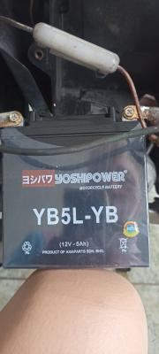

My question is simple but I can't really get an exact answer online so I try my luck here.
Is battery without Sirim certified and Manufacturer Date = Fake / Counterfeit product ??
I bought a Yoshipower YB5L-YB battery last month but it is dead now and I found out the item have no Sirim certified and Manufacturer Date label anywhere of the battery hence the question.
By the way what's the different between YB5L-YB vs YB5L-BS ?? Thanks

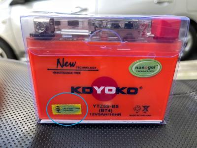

Those yb5l I think its battery size. I never see baterry with sirim. Got meh

this is cheap china brand battery
pay peanuts get monkey, all that i am saying
u want good and reliable motorcycle battery? i only use GS YUASA
there's a reason why its more expensive than others

KOYOKO's are shit batteries
expensive and doesnt last long. bad experience for me
out of the box from the seller, he tested, battery dead. he took another 3 and all dead. the 5th one alive. took back, used it for 2 days its dead

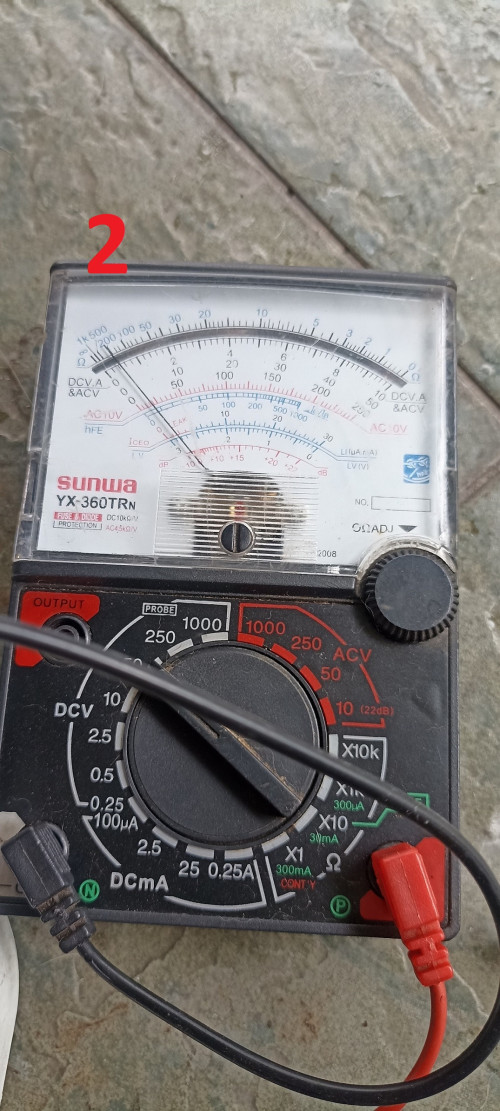

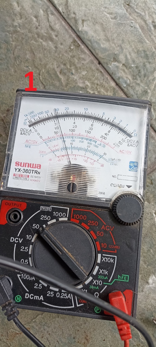

This lousy Yoshipower is from one of the Seri Kembangan motorshop. I always go Shopee first for buying anything but have no choice to get one immediately otherwise can't use the bike to work so it is what it is.
It sold only RM40 in Shopee while the motor shop price RM65 and can't even last for a month, epic fail. luckily they agree to replace another one but who know how long this one will last.
Different people different experience. My last 2 batteries actually bought from Shopee seller which has "Prefered" + "100% Authentic Guaranteed" label and went quite ok. Both Amaron brand & last longer than 18 months.

Yeah I have multimeter and the battery is confirm faulty and had been replace a new one. I thinking to buy Amaron again when this new but cheap replacement dead. The last 2 Amaron that I bought from Shopee serve me very well.

Koyoko are gel batteries, cannot overcharge
