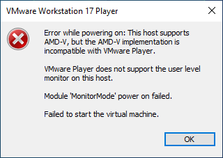

I got this error, saying my AMD-V is incompatible with VMware. Looks like must use Intel VT-x.

For Hyper-V Enabled Hosts
CPU Requirements:
Intel Sandy Bridge or a newer CPU
AMD Bulldozer or a newer CPU
which AMD CPU are you using right now?

Oh, I see, so old AMD CPU is not supported...... I thought it affects all AMD.

from VMware forum, they raise the system requirement for v17.

Check your mainboard BIOS/UEFI configurations and look for :-
1. VT-x
2. VT-d
Enable both of these features.
If the above is not available, then the system unable to support any virtualization irregardless which Virtualization Platform you use (eg. VMWare, VirtualBox, Xen, Hyper-V etc.).
If the above requirements are enabled, then you might need to use an older version that supports your current CPU. As you are using "VMWare WorkStation 17 Player" maybe you try older version like "16" instead.

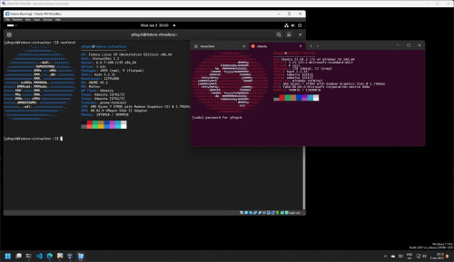

If your pc has enough ram, you can run both but just forget VMWare player, it hasnt been working correctly for months, it throws more error than Virtualbox/Hyper-v and the error is usually unfixable.
Virtualbox works great and works fine together with WLS
i could probably add hyper-v too

If WSL/Hyper-V and Virtualbox works fine with AMD
there is something very wrong with VMware itself,
it's not related to CPU.
