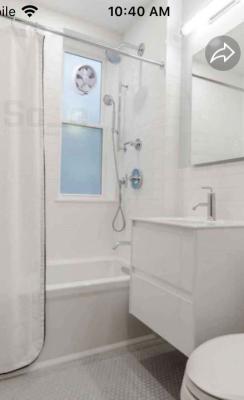

Hi guys, need to ask if you guys have any contractor to share that has installed a fan like this in a bathroom? Needs to cut a hole in the glass window to install. TIA.

i found shop in puchong can do this. The only problem, the guy ask me to dismantle the windows and bring to the shop. He asking around rm30 to make the hole

Any experienced electrician can do it.
Wahliao.. how to dismantle window to being there? 😅
Really? Have to cut a hole in the window wor.. electricians can do?
https://shp.ee/msh63a7
Similarly, I brought the dismantled window panel together with the fan to a picture framing shop where they cut to suit.
You can ask your contractor or condo building management to help.
Only 2 screw holding each side , anyone can do it , matters of want do or not .
Oh that's a good suggestion, thanks! Yeah, have already asked the condo management and contractor, no luck, they can only do the ones without cutting the hole.

these kind of axial fan is useless one. If you really need ventilation in a closed toilet you need ducted axial or centrifugal to have any meaningful extraction.
Ah I see... but my bathroom isn't that big? Hahaaaa. Purpose of the fan is just to help vent out some of the humidity and smell.

Bought the new house in a condo, working on the renovation. Want to ask the sifu here: instead of installing the exhaust fan in the windows, is it possible to install it on the bathroom plaster ceiling? The challenge is that bathroom plaster ceilings are a closed area, with no exit point for the air. See any advise or design i can copy. budget request thumbup.gif
usually 2 different contractor doing that. electrician will pull wire, then ask urself find another contractor settle your window
