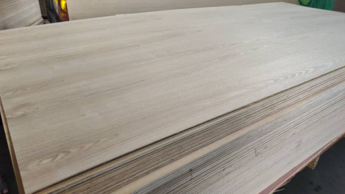

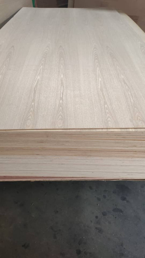

Heres the sandeply. Quite light colour wood, abit like birchply, but more interesting woodgrain. Supposed to be more durable than birchply.

look like what they call china ash. not really ash, just something out of china factories.
good luck with hand finising using wipe/brush on oils. maybe one table top i would do that way.. 200sf... better use floor finishing technique. osmo should have the tools for the job
