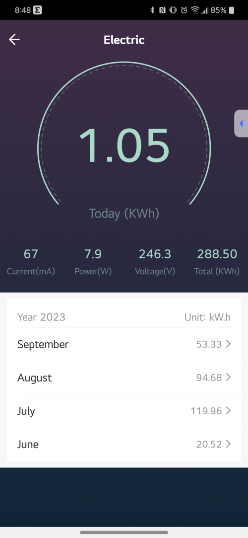

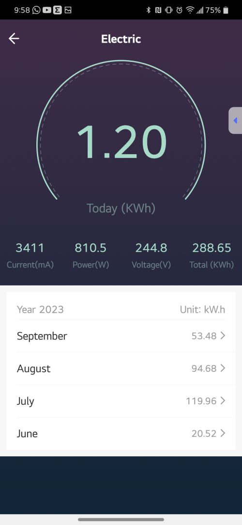

For my ac (1HP, Masterbed room) I tend to use 25C or 26C at fan speed 1. The pic below is 26C at fan speed 1.
Compressor ON:
Observed range from 600-800+ watts
Compressor OFF
7W
All my rooms have no fan installed. Hence the need to control AC usage. I set all either to 25 if too hot, or 26 if colder weather like now. Total monthly usage shown in pic also.
This post has been edited by bismaximus: Sep 23 2023, 10:03 AM

il0ve51
post Sep 26 2023, 12:56 PM
1,056 posts
Joined: Jan 2008
QUOTE(bismaximus @ Sep 23 2023, 11:02 AM)
Compressor ON:
Compressor OFF
7W
what app is this?
