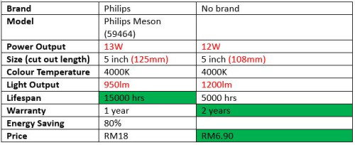

Recently I came across few downlights on Shopee/Lazada but do not know how to differentiate branded vs no brand LED downlights. See below for my comparison.
Philips: https://shopee.com.my/PHILIPS-MESON-59466-1...3f-a5d358846695
No brand: https://shopee.com.my/product/244022032/4781463737
The one I highlighted in green means superior than the another. Philips' lifespan is 15000 hrs which is 3x more than "no brand" but the price RM18 is almost 3x. In terms of warranty, Philips can only provide 1 year. Should I consider to go for no brand since it can provide 2 years warranty? Usually what are the coverage during warranty period?
Does 1200lm (no brand) perform better than 950lm (philips)? Will it be too bright? Will there be any difference in terms of color temperature based on same 4000K for Philips and "no brand"? Will it provide same functional lighting and atmosphere?
Philips stated that it can give 80% energy saving. Do you think "no brand" can give the same assurance?
Besides pricing, warranty, the other things to consider is easy of installation (for future replacement), please advise if "no brand" can easy to install as well.

QUOTE(goolie @ Sep 11 2023, 09:52 AM)
Wonder that no brand spec is trustable. RM6.9 for 2yrs warranty?

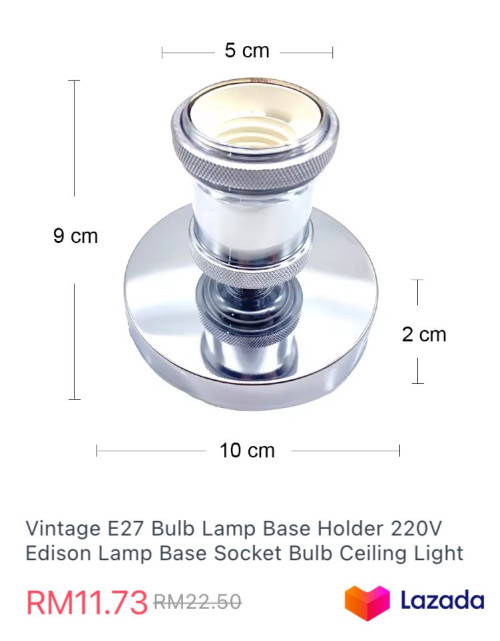

QUOTE(YLT @ Sep 11 2023, 10:02 AM)
For me, Important is:
1) Bulb holder must be porcelain. Do I need to explain why porcelain?
2) The light bulb should save electric.
3) The light fixture look futuristic and nice.
Did I tell you I worked for lighting shop > 8 years?
For my case, i want to install led E27 light bulb as the downlight cause i won’t install plaster ceiling. My question is, what type of bulb holder is the best in terms of durability and safety.
Found this on Lazada but not too sure if it save for long term use

QUOTE(Bijisss @ Sep 11 2023, 02:06 PM)
There are all durable and safe. You hardly touch the Light fixture accept change the bulb.
For safety, makesure ground the light fixture body if it metal. It is the workmanship that ensures the safety.
The bulb socket mostly is plastic. It will crack after like 10yrs. Cause the heat will degrade the material. If you can find the porcelain, ceramic or bakelite type is the best.
I would go for surface mount LED downlight. Any protrusion like object will attract spider for its construction laugh.gif Something like this (unless you like vintage look)
https://shopee.com.my/LED-Surface-Mount-Dow...09-92df3171dff4

QUOTE(goolie @ Sep 12 2023, 01:40 PM)
I decide to go for branded LED downlight. But, i heard one contractor said that philips LED will be more difficult to install. Is it true? He advised me to go for Megaman or OSRAM. Both also from Germany. I believe all of them are same quality standard, right? or do you have any thoughts on this?
For Megaman 5 inch 12W, I can get better deal at RM16.90/unit with 2 years warranty. Have not negotiated yet. I was thinking to get lower rate with bulk purchase 20-30pcs.
For Philips with same size & power output the  best deal I can find is around RM17-18/unit with 1 year warranty only. Another deal is RM22/unit with 2 years warranty.
Should I go for Megaman? Anyone using this brand b4?
Question: Which one is better? and why?
1. Megaman beam angle: 120°
2. Philips beam angle: 110°
I have seen a demo by one of the PHILIPS Professional Partner in my condo demo.
As per normal our corridors were using those generic China LED DL D150 18W (rated 1500lm). They showed up with an equivalent D150 size DL but running only 12W (rated 1300lm). Hence it is a direct fit.
The generic China 18W when measured using a light meter only got about 70-80lx while the PHILIPS 12W under same condition got 110-120lx.
They then bring up another unit same sized but running at 9W (rated 950lm) and was measured at 65-75lx. Now JMB deciding to go for 9W or 12W model. Running 12H per day, every 1W saved is equivalent to RM 2.40/year. The unit offered is with 5-Yr warranty.
