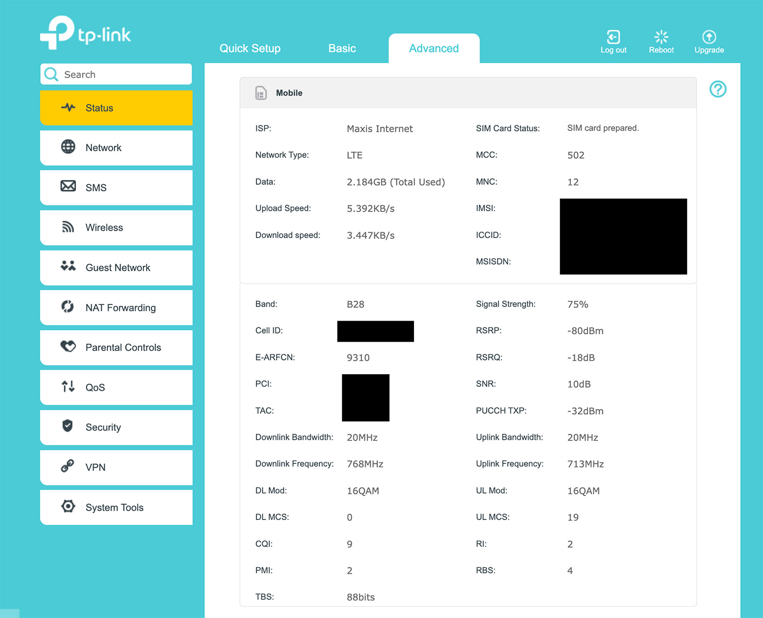

started from last night, my Maxshit 4G no longer able to lock b28, but other telco can.
anyone experience the same?
Aug 29 2023, 07:40 AM, updated 3y ago
anyone experience the same? |

4,157 posts Joined: Jan 2003 From: Cheras, KL |
QUOTE(dark_axl21 @ Aug 29 2023, 08:20 AM) maxshit some area very congested even carrier aggregation with band 1+3+7 also get 20mbps only.b28 is anchor band for 5G nsa, so lock to b28 no need congest with other 4G users on band 1/3/7. before this, lock to single band 28 only can get 30-50mbps or higher for 4G. been using for a year suddenly last night no longer can already. This post has been edited by BOTAK_WAI: Aug 29 2023, 08:36 AM |
QUOTE(Zot @ Aug 29 2023, 08:38 AM) Since the DNB has right for the LTE Band 28, probably the band is now utilized for the 5G. Furthermore Maxis is now offering 5G service. memang all the time b28 is used for 5G nsa together with n78but now maxshit 4G no longer able to lock to b28, while other telco still can lock to b28. |
Aug 29 2023, 09:16 AM
#10
1,524 posts Joined: Dec 2020 From: Perak |
QUOTE(BOTAK_WAI @ Aug 29 2023, 08:50 AM) Saya faham yang awak mahu guna Band 28 milik DNB pada rangkaian 4G MaxisTapi awak juga perlu tahu bahawa Maxis ada hak untuk tidak benarkan pengguna mereka untuk akses rangkaian 4G Band 28 (Anchor band), memandangkan Band 28 tersebut bukannya milik Maxis, sebaliknya milik DNB. Maxis hanya ada lesen untuk 4G Band 1,3,7,8 sahaja. Kalau awak mahu guna sambungan internet Band 28, awak mestilah menggunakan sambungan 5G. Band 28 hanyalah anchor band sahaja. Mungkin Maxis tidak seperti telco lain yang membenarkan pengguna mereka akses 4G Band 28 DNB tanpa perlu menggunakan sambungan 5G. hyperyouth_firepower, Stirmling, and 2 others liked this post
QUOTE(aniq8676 @ Aug 29 2023, 09:16 AM) Saya faham yang awak mahu guna Band 28 milik DNB pada rangkaian 4G Maxis sila tengok post pertama, saya nak tanya ada orang yang pakai maxshit 4G dengan b28 adakah sama tak boleh lock lagi. itu je.Tapi awak juga perlu tahu bahawa Maxis ada hak untuk tidak benarkan pengguna mereka untuk akses rangkaian 4G Band 28 (Anchor band), memandangkan Band 28 tersebut bukannya milik Maxis, sebaliknya milik DNB. Maxis hanya ada lesen untuk 4G Band 1,3,7,8 sahaja. Kalau awak mahu guna sambungan internet Band 28, awak mestilah menggunakan sambungan 5G. Band 28 hanyalah anchor band sahaja. Mungkin Maxis tidak seperti telco lain yang membenarkan pengguna mereka akses 4G Band 28 DNB tanpa perlu menggunakan sambungan 5G. apa yang awak cakap tu i pun faham. |

13,477 posts Joined: Jan 2012 |
QUOTE(BOTAK_WAI @ Aug 29 2023, 09:28 AM) sila tengok post pertama, saya nak tanya ada orang yang pakai maxshit 4G dengan b28 adakah sama tak boleh lock lagi. itu je. Chill...apa yang awak cakap tu i pun faham. When I disable every band except band28 on my S9+ (Hotlink), it showed Band:PGSM900 (usually it would show the band number) and my phone only gets 2G. Still, I'm kinda surprised that they are allowed to use 4G on band 28. This post has been edited by andrekua2: Aug 30 2023, 08:23 AM |
QUOTE(andrekua2 @ Aug 30 2023, 08:22 AM) Chill... ya…before this can locked to b28, now select b28 will be connected to 2G.When I disable every band except band28 on my S9+ (Hotlink), it showed Band:PGSM900 (usually it would show the band number) and my phone only gets 2G. Still, I'm kinda surprised that they are allowed to use 4G on band 28. it's quite good experience for 4G user to use b28 because can get 30-50mbps speed constantly, while b1/3/7 very congested normally only get 20mbps and below. QUOTE(pokemon @ Aug 30 2023, 08:31 AM) Seems like MaxShit is forcing its customers to upgrade to 5G with higher fee. When customers complain slow speed, the solution is to upgrade to 5G plan. yea…other telco 4G still can locked to b28, maxshit je can't.ppl rather shift to umobile rm68. even digi i150 users also shift to umobile to save money. |

2,431 posts Joined: Feb 2010 From: Alam Damai |
QUOTE(BOTAK_WAI @ Aug 29 2023, 07:40 AM) started from last night, my Maxshit 4G no longer able to lock b28, but other telco can. You pure 4G subscriber? They block 4G users to attach band 28 due to Volte call drop issue when phone handover to band28.anyone experience the same? If u 5G user, they cannot block this, so the volte call will drop if phone move from good b28 coverage. but if u are 5g user profile then i duno d... This post has been edited by prosibu: Aug 30 2023, 12:15 PM |
QUOTE(prosibu @ Aug 30 2023, 12:15 PM) You pure 4G subscriber? They block 4G users to attach band 28 due to Volte call drop issue when phone handover to band28. yea…using business postpaid.If u 5G user, they cannot block this, so the volte call will drop if phone move from good b28 coverage. but if u are 5g user profile then i duno d... but that's just an excuse for them to force user pay more for 5G. because phone will normally automatically connected to b1/3/7/8 and not b28. for those who purposely lock to b28 with 4G/5G router won't care about phone call. |
QUOTE(BOTAK_WAI @ Aug 30 2023, 12:37 PM) yea…using business postpaid. No lar. For nationwide, really many call din handover to 2g.. but handover to b28 due to wider coverage...but that's just an excuse for them to force user pay more for 5G. because phone will normally automatically connected to b1/3/7/8 and not b28. for those who purposely lock to b28 with 4G/5G router won't care about phone call. And force band is not normal user behaviour, i dun think they will care about these users... |
