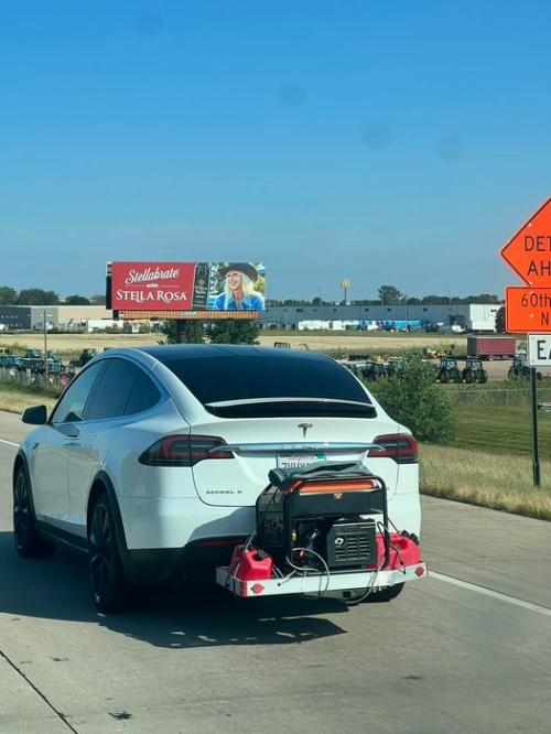

buy a small generator to change your Tesla.

QUOTE(azbro @ Jul 16 2023, 10:34 AM)
Got solar charger already, you can try.

Pakai generator je

QUOTE(oM41GoD_ @ Jul 16 2023, 12:15 PM)
Pakai generator je
just wonder what is the mile/gallon are they getting. i believe it could be worst than vios.
