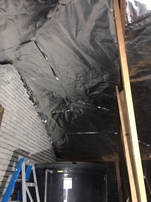

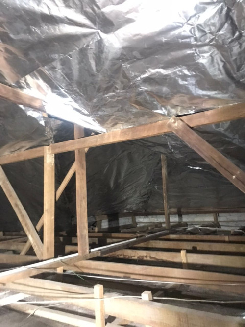

Decided to do a radiant barrier installation on the roof instead. How I did was:
1. Purchase material rolls directly from supplier (Find supplier from Shopee/Lazada and contact them to do pickup orders), comes in ~40-48m per rolls. Found 3 suppliers, 1 in Kajang, 1 P. Pinang & 1 Melaka. Just find the closest to you.

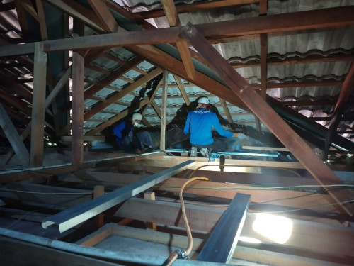

2. Find contractor to do roofing works, show video instruction on how to do.
3. 1 / 2 days job depending on roof size / design, contractor provide tools & labour.
Feedbacks & comments:
1. Cost = RM170/roll for 48m roll, bought 4 only used up 2.75 (House buildup 30*65). Labour+tools = Rm700
Total cost RM1.4k-ish. Not sure yet what to do with the leftovers.
2. Good quality product, does not tear easily (woven) and warranty is 15 years.
3. Workmanship not that important (could be better aesthetically, but not as important to serve intended purpose) sweat.gif
4. Pretty good results for a low-cost passive solution (no numerical temp. measurement done before / after, but 2nd floor is noticeably cooler in the evening) thumbsup.gif
Some pics for reference:

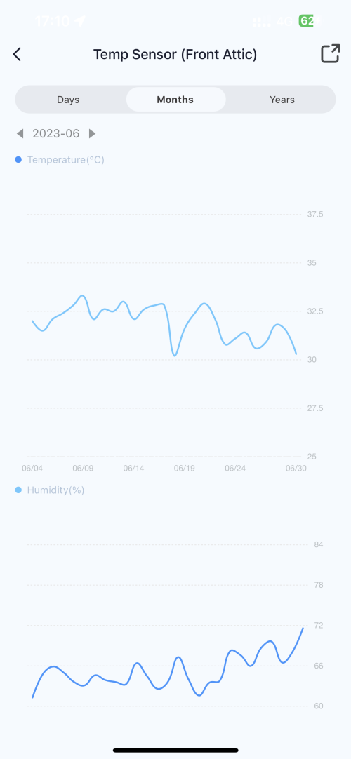

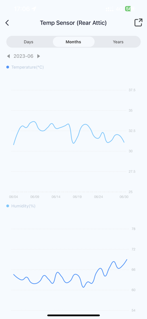

Did you measure the temp difference?

Don't have a temp. gun on hand so didn't measure, but I don't get headaches anymore for the whole week living on 2nd floor. Other family members also commented on it being noticeably cooler.
