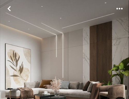

Hi guys, im planning to do some simple plaster ceiling design with LED tracklight and LED downlight like the attached photo.
Just a question, if i just turn on the LED tracklight without the LED downlight, would it be bright enough to light up the space like how L Box lighting is bright enough without turning on the LED downlights?
Also, do I use LED strip for the tracklight? I cant seem to find different spec with brighter LED strips though. Or do they use like T8 instead of strips in the tracklight?
Thanks!

Im actually comparing to the brightness of L Box plaster ceiling design since i plan to do this design instead of L Box for easy maintenance.

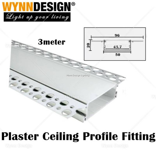

If not mistaken, TS is not using magnetic track light but rather recessed aluminium profile.
These normally integrates LED strips which are not bright in nature, but are more for ambient lighting.
In my opinion, T5 cannot be fitted in ordinary aluminium profiles.

yup, im just using aluminium profile with high brightness COB LED Strip together with downlight&eyeball..
haven't completed my renovation yet though so cant really tell if the LED strip would be bright enough or not.. but i do have multiple eyeball to add brightness if i don't want to turn on the downlights

LED strip used is SMD2835 120LED 24v with plaster ceiling aluminium profile.
The brightness is definitely sufficient, just the LED strip alone is brighter than my dowlight+eyeballs combined.
But please do note that if you want to use this set up, aluminium profile needs to be more than 1cm depth so that you don't get dark spots from the LED strip. Or else, you'd have to go with COB LED Strip which is lower in brightness but won't have any dark spots.

When you purchase, the strip case should already be design for this use, usually is 1.2cmx.1.2cm and with wing to be installed to the plaster ceiling. COB LED will not have the dark spots, worth the upgrade.

yup, living room and dining area, i chose 2835 120LED 24v with the deeper 1cm plaster ceiling aluminium profile as the LEDs are close enough to not show any dark spots, and since this is brighter than COB LED strip, i chose this instead to act/replace Lbox design plaster ceiling
