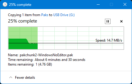

i try a 6GB file single file, when start 25MB/s
after about 2 min

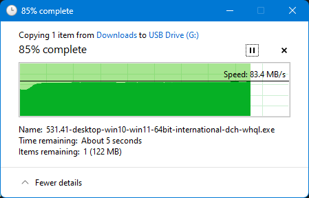

I’m not sure but looking at ur pic, it is 32GB. If is formatted to fat32 or ntfs? Can try ntfs if it’s not

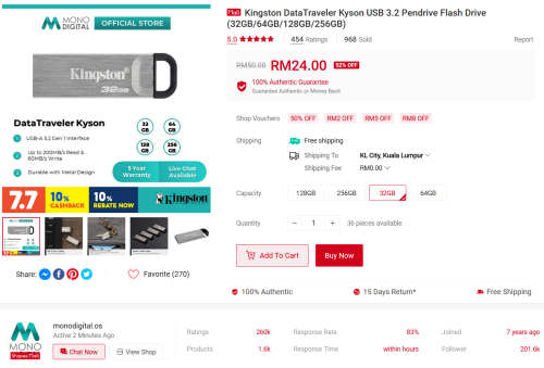

brought online? becareful.. alots is fake. but price rm85 for 32gb a bit pricey. some selling cheap is pasar malam quality copy right design alike orignal kingston. but the actual capacity is small n read/speed is low.
else get from OS store sure is original

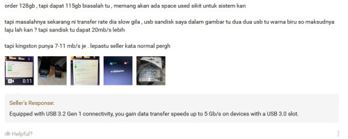

looks like this Kingston pen drive is meant to be slow and not fast... it just say USB3.2 interface but never really provide the actual write/read speed...
https://www.youtube.com/watch?v=-Gv2I1AGXXo
https://www.kingston.com/en/usb-flash-drive...usb-flash-drive
it says Gen USB3.2 compliance only.....it's a good lesson learn for me...

QUOTE(kevyeoh @ Apr 2 2023, 10:49 AM)
I guess I got conned by Kingston marketing....and i am also not that knowledgeable here... I thought as long as it says USB3.2 interface then it should be as fast as USB3 should.... lesson learn... smile.gif it cost me RM85 and I checked at shopee...some other USB3 pen drive for 256GB also around there or slightly more expensive so I thought it's market price also there about...
This is original. Or you can find in Kingston mall but they usually out of stock for 32gb for USB3.2
So far my experience with Mono Digital is good.
