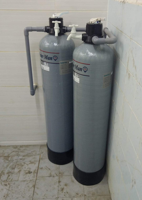

bought normal outdoor water filter. instead of one, pasang two at melaka apartment. modified the pipe to go indoor. malas to go for those indoor water filters...

QUOTE(burn22 @ Apr 1 2023, 05:15 PM)
2?? that means you sacrificed water pressure. The more filters, the weaker the water pressure

QUOTE(empire @ Apr 1 2023, 06:29 PM)
ground floor, no issue!!
wanted to add in electric pump, decide not too...

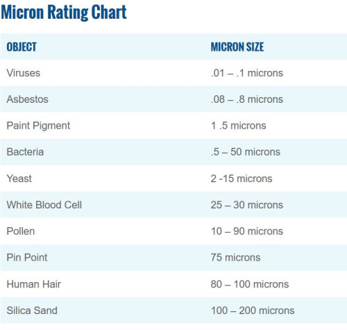

as the filter density up to 0.01 micron, does the mineral in the water will be get blocked by membrane filter?
Heroicage
post Dec 3 2023, 09:48 PM
265 posts
Joined: Jan 2013
QUOTE(philipkyw @ Dec 3 2023, 05:29 PM)
IMO,
What does a 0.01 micron water filter remove?
Nanofiltration would include the removal of particles that range from about 0.001 to 0.01 microns.
This is also a pressure-membrane-driven process that should remove some dissolved solids, viruses, aqueous salts, pyrogens, and endotoxins.
There is a site here, that shows a chart on what gets removed.
https://www.freshwatersystems.com/blogs/blo...water-filter-be
only way to remove minerals are distillation ( convert the water into gaseous format and condensation back to liquid ) OR Reverse Osmosis.
Mine is membrane and has 10 micron filteration (microfilteration, not nano ) , and not 0.01 micron....so, not exactly sure your usage purpose.
It will remove undissolved minerals for sure but not all minerals will be completed removed. Only RO/distillation will completely remove them.

Hey, I end up with this water filter.
https://shopee.com.my/AQUAMAN-Outdoor-Water...6666.2104771400
I'm happy enough as long as the water is clean. I do have an indoor water filter for drinking water. Can see the indoor filter is clean all the time.
FYI - I use SS 1042 model
haha just got this installed as well. ss1042. but the filter already came with the media inside, so cannot see how's the quality of the media.
btw just wandering if need to put a cover on top of the valve? since mine is put directly under the sky
