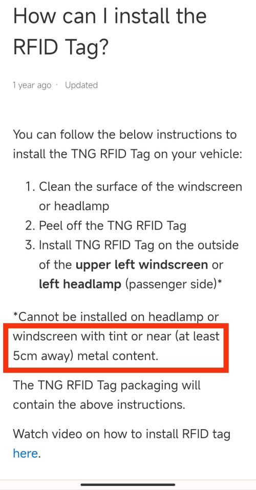

Solution for long queue at RFID lane:
Reinstall all RFID tag from windscreen to headlight for free

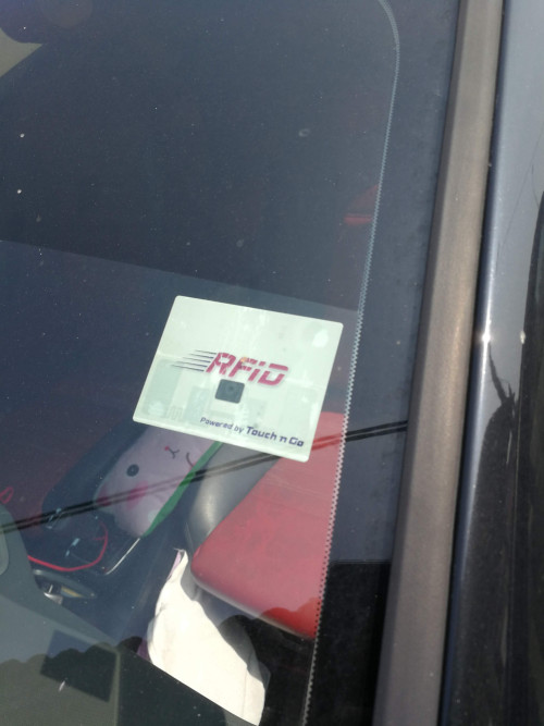

Windscreen edition RFID
QUOTE(BuKeYi @ Feb 2 2023, 04:28 PM)
Found it at my google photo.

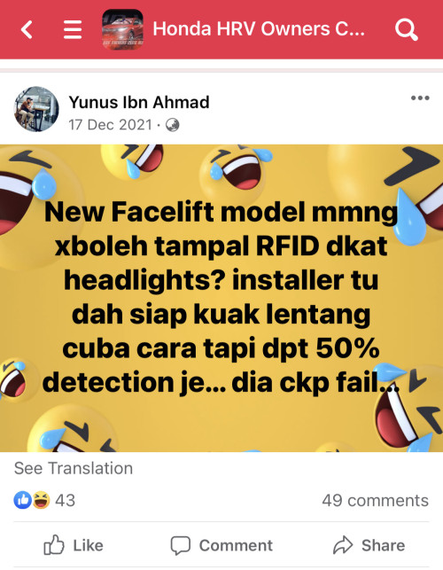

Lembu Goreng
post Feb 1 2023, 11:28 AM
1,129 posts
Joined: Feb 2021
TS, you obviously do not know that for some cars the headlights are 'curved in' so the rfid cannot detect. This is a known issue with new honda HRV. Also an issue with my volvo.
No choice but to place on windscreen, and yes we do go to proper installer but still the detection is poor

chtan
post Feb 1 2023, 11:29 AM
2,353 posts
If you have metalized film on your windshield, you will surely have a hell of a problem getting it thru.
