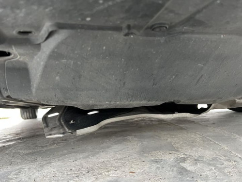

as per title, sometimes car carry more than x amount of weight and forgot about it, jump over a bump and hit the bottom, how much does it damage the car ?

Depends how hard and where you hit.
Usually the damper bump stops will take most of the weight if it fully compresses.
On flat surface no issue. Even cars that jump a parallel speed bump at high speed would have the front bumper scraped and the bottom splash guard and/or oil pan scraped.
But uneven launches..... can almost be certain the oil pan gone. Last time Boy96 showed his DVR where he was launched off a sharp divider and his car oil pan gone.

depend where and how hard it hit
it might worse as gearbox or oil pan bocor; exhaust muffler bengkok or tercabut ; fuel tank
or chassis bend and deep scratches
This post has been edited by fantasy1989: Jan 3 2023, 02:38 PM

No way it can hit fuel tank. You will need to destroy your entire rear drivetrain to hit the fuel tank.

QUOTE(bengm2019 @ Jan 3 2023, 03:28 PM)
https://www.facebook.com/watch/?v=1186945445278993
something like this with sharp object + luck
