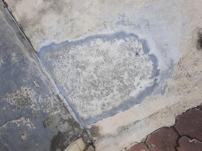

mini orchard
post Dec 30 2022, 09:56 AM
10k Club
14,511 posts
Joined: Sep 2017
This is the spot that leaks as per post #7
