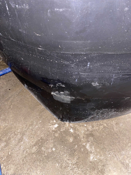

Before sealing:-
After sealing:-

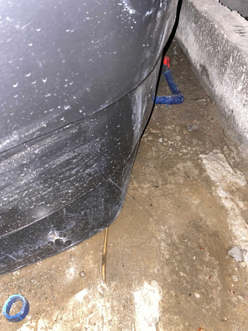

inspected. cracked at the bottom body of the tank
