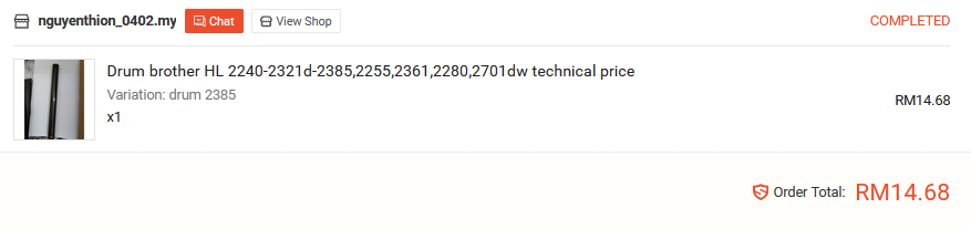

Brother laser printer, everytime finish printing have to clean drum. If not next printout will be dirty.
sepatah dua kata pls hmm.gif Need to clean everytime?

Drum cleaning blade already koyak. Change cleaning blade. If cartridge type. Change whole drum unit.

TS, its either you are not using original toner/drum or the drum is too old over the life span, the residue would be too much in volume that the drum blade can't be cleaned.
Normally drum needs to be clean each time you change a new toner.

QUOTE(IccyAsd @ Dec 13 2022, 04:47 PM)
TS, its either you are not using original toner/drum or the drum is too old over the life span, the residue would be too much in volume that the drum blade can't be cleaned,
problem is the leak..
during printing, it leaks tiny bits of toner to the drum or shall i say the drum has toner residue and i see toner residue on the green plastic catridge. everytime i need to clean the drum now. laugh.gif

QUOTE(Selectt @ Dec 13 2022, 04:53 PM)
original toner doesnt leak that much, only OEM/Clone leaks every print.

For inkjet printer, auto-clean will be executed periodically if you turn on the printer. Therefore he's not wrong, technically. But it is not apply to laser printer with currently you're using since you mentioned a drum unit. Low range Brother printer is like this, especially you're using non-genuine cartridges. I bet your drum model is DR-1000 icon_idea.gif
