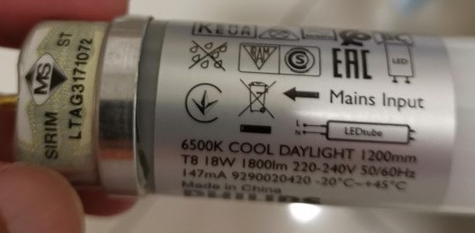

My bedroom is currently using LED T8 tube lighting.
Today, the LED decided to die.
I buy a Philips EcoFit LEDtube T8 from my nearest convenience shop. Unluckily, there is no testing provision at the shop.
I unbox it at home. It comes with an EMP starter. I guess it is meant to be used for replacing classic fluorescent with ballast setup (which is not applicable for me).
I have no choice but to salvage an LED tube from my spare room and install it in my bedroom. Now it works. Does that mean the Philips EcoFit LEDtube T8 is not a direct replacement to a standard T8 LED light?

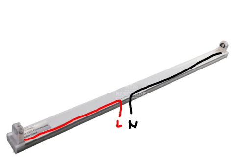

Typical casing is wired like this

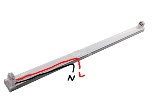

Need to change it to this if using the Philips tube

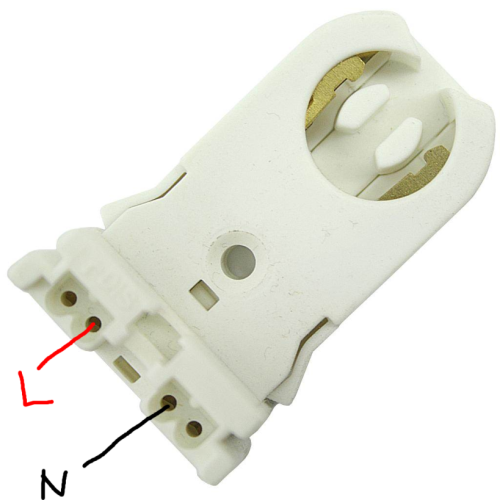

Take out one wire and cucuk into the hole of the holder on one side

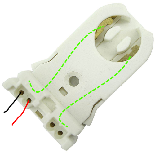

DON'T CUCUK LIKE THIS! Because the holes on each side are connected together

But this picture also shows the same Method 2, Image 4
