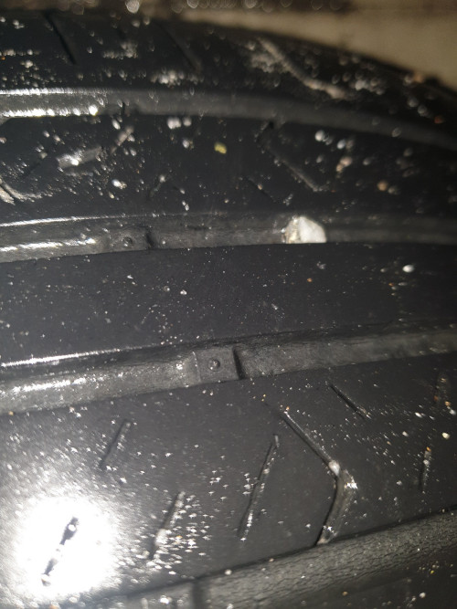

Hi sifus, I would like to seek your advices regarding this.
I'll be changing my left rear tyre as it has already reached its wear limit. So I'm wondering if I should also change my right rear tyre for the sake of consistency? It hasn't reached its wear limit yet (still has about halfway to go?) but the thing is that it's more than 4 years old as of now.
The reason both tyres have such a big difference in wear is because my left rear tyre punctured not long ago and I switched to a much older tyre.
Thank you all in advance.
Pic of the right rear tyre wear level below:
metalfire
post Oct 27 2022, 12:23 PM
1,289 posts
Joined: Oct 2005
time to change both, and maybe keep the better one as spare, just in case.
zeng
post Oct 27 2022, 06:08 PM
1,810 posts
The 4yo rear right tyre is still serviceable.
Isn't the previously punctured tyre repaired by now?
6UE5T
post Oct 27 2022, 09:03 PM
1,704 posts
Joined: Sep 2012
If you just buy a new one, you'll be faced with the same dilema again later. So either you buy 2 new ones or try find the same used one still in good condition. Up to your budget I guess.

ktek
post Oct 27 2022, 10:22 PM
小喇叭
13,187 posts
Joined: Jul 2006
prefer change in pair (2pcs) or rotate with spare one
TSadultingishard
post Oct 27 2022, 11:50 PM
6 posts
Joined: Feb 2022
Alright I will consider changing both tyres for peace of mind.
QUOTE(zeng @ Oct 27 2022, 06:08 PM)
The puncture was pretty bad, the hole size was about 2 to 2.5 cm, and it happened in the sidewall so it couldn't be repaired apparently
