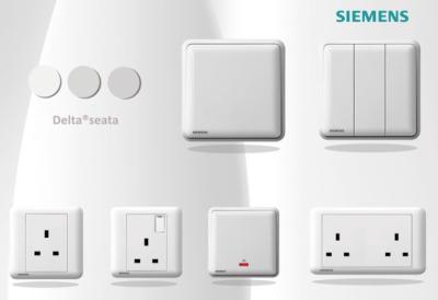

Are SIEMENS switches ok? I think they are made in China.
mini orchard
post Oct 6 2022, 06:59 AM
10k Club
14,511 posts
Joined: Sep 2017
QUOTE(BrunoMalaya @ Oct 6 2022, 02:16 AM)
Most of the world household products are now made in China, Ikea included
I believed they have proper QC and not made by those backyard factories.
If you want from origim country, if any, the price will be much more expensive.
