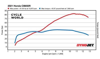

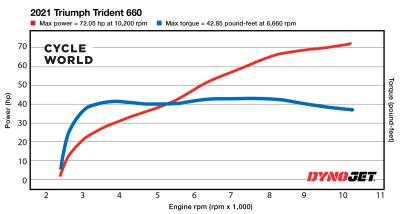

One thing to remember is that with the new Triumph models post 2021, you can no longer reset the service reminder (spanner icon) yourself... unless you buy a very specific Bluetooth OBD dongle and pay $30 yearly for the TuneECU app. You have to go back to the dealership to get rid of it, even when out of warranty. I have no issue with it though, coz it's reassuring to know that only trained people touch my bike and they put genuine stuff in it.
The Trident triple will never be the screamer that the CB650R inline 4 is. It's just physics. I used to own a 400cc inline 4 back in the day and that thing just had to the thrashed above 6000-7000rpm all the time, because the nature of inline 4 is that its power is almost always heaped at the top half of the RPM range. If you like high-revving engines and like to squeeze every last horse out of the engine when you ride, this one's for you.
The Trident is a little different. If you compare the dyno charts below (rear wheel hp & torque, unlike the manufacturers' spec sheet numbers that are measured at the crank), the biggest diff is in the fact that the Trident's triple lets you access almost 100% of its torque from 4000rpm onwards. The slight hole at 5000rpm is probably to meet emission requirements. The CB650R only hits 88% of its torque at 5000rpm, with a bigger hole at 6000rpm before matching the Triumph in power and torque at 7500rpm. Its horsepower advantage over the Triumph only comes after 8500rpm.
With the Triumph giving easier access to its full potential, it suits my wife for the kind of riding that she does. It might not suit you though, if you enjoy thrashing a screamer down the road when you ride. But that's as far as we're able to compare, because a CB650R demo bike simply doesn't exist.
If you're willing to take the Honda's premium pricing, you might also consider the GSX8S with its introductory discount. No replacement for displacement! But then, it isn't a screamer either with its 270-deg crank parallel twin... but from what I hear it's a fun torque monster. And, knowing Suzuki, it'll probably stay current for the next 6 years before they introduce an improved model lol. The only other option for you is then the Z900 non-SE at RM44k which represents a ridiculous amount of bang for your buck. If you want screaming performance, it blows every fucking thing in that price range right out of the water.
Attached Image Attached Image

QUOTE(ZZR-Pilot @ Dec 21 2023, 01:41 AM)
Except for the first 1000km service (which was free coz I got a RM500 voucher when I bought my bike), I have always brought my own engine oil to Fast Bikes. Which is why I keep going back to them, esp now that my warranty has expired. I dunno about Goh Brothers though.
Well I'm not exactly shopping for a bike since I already bought my Katana haha. Maintenance wise I just go with their standard service package inclusive of original Ecstar R9000 Japan oil as it isn't too expensive.
But why I say the Trident could benefit from an increased redline is if you look at the dyno chart, all the way at the end the HP is still increasing, meaning if the engine can handle just another 1000-2000rpm, the power would still continue increasing before it starts falling. Look at the Cb650r dyno and the hp had already started falling 500-1000rpm before the redline.
Honestly you will rarely request for full torque at such a low rpm so even 80% of the full torque is still aplenty available. I actually managed to get a test rode on the Cb650r last year after I placed a booking on the Cb650r. Was very fun to ride, but the exhaust is pretty muted and the bike feels quite small for me.

QUOTE(Nightstalker1993 @ Dec 29 2023, 01:05 AM)
Can't say for sure, to be honest. The CB650R goes all the way to 12000RPM (being an inline 4 with a shorter strike, it's probably eager and able to), but in reality there's nothing left to give past 10,000rpm coz the horses trot downhill from there. It might be the same for the Trident, and if it too goes downhill past 10000rpm then that might be a good place to place the limiter to avoid overstressing the engine.
That said, though, the 675 which the Trident's 660 engine is based on does go all the way up to 14000rpm, peaking at around 108 horses @ 12500rpm. So in all likelihood, the Trident's cap at 10000rpm could also be intentional so as not to encroach into the Street Triple territory. Product differentiation they call it. Lol. They did the same trick to the Tiger 850 to differentiate it from the Tiger 900. Exact same engine, but the ECU is castrated past 7500rpm where the 900 ekes out another 10 ponies from there to the 10000rpm redline. Honestly I don't know of anyone who habitually rides their middleweight ADV by bouncing it off the limiter, though.
Your service intervals are interesting. Why is it due for service every 3 months? If you go by mileage instead, will it void the warranty?
This post has been edited by ZZR-Pilot: Dec 29 2023, 01:05 AM
Nightstalker1993
post Dec 29 2023, 01:00 AM
M� �R�|�
8,930 posts
Joined: Nov 2005
From: Subang Jaya
QUOTE(ZZR-Pilot @ Dec 29 2023, 12:51 AM)
Even if the hp drops by 10%, you're still accelerating faster at the lower gear than if you were to upshift earlier due to torque multiplication to the wheels by the gearing.
The service interval of every 3 months is just bullshit. I argued with the service agent and said the warranty booklet says the warranty is valid as long as the bike is serviced as per the user's manual, and the user's manual says to service every 6000km or 1 year. So in the end I managed to get them to set the service reminder at 1 year instead of 3 months and if I do need warranty and they want to reject it for not servicing every 3 months I'll just show them the manual.
Getting you to service every 3 months is just a cash grab by the dealers. Imagine doing valve clearance every year eventhough your bike is only at 6000km. Ridiculous! Honda BW also recommends 5000km service interval last I spoke to them when their manual recommends 10k km if I'm not mistaken. But at least Suzuki service follows the book's maintenance schedule on items to perform, just the time between service they butchered.
What's really interesting though is according to the service agent, the major service price is inclusive of valve clearance check. The labour seems too cheap to include a valve clearance check but the SA said the displayed price on the list is the final price I have to pay so.... We'll see in 4 years of that's really true.
