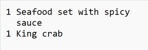

Hi, can u guys help how to print receipt like above ?
The sauce will go to next line but under the food name.
2022-08-17: If combine with chinese word, this text calculation method is not longer workable due to font size different.
Can help ?

It's similar to console / text mode output.
You have to manually adjust space.
Please take note if you have quantity 10++ you may have alignment issue.
use "^" to indicate space :
CODE
1 x Seafood set with spicy
^^^^sauce
1 x King crab
10 x Seafood set with spicy
^^^^^sauce
There is another display style :
CODE
sauce^^^^^^^^^^^^^^x 1
King crab^^^^^^^^^^x 1
sauce^^^^^^^^^^^^^x 10

Hi there, I see you are doing ESC/P printing.
Basically @flashang is correct.
I did the same thing 2 years ago, using C# for Windows, for splitting long lines to multiple lines, and multiple columns.
How to improve this C# code? (Print multi-column multi-line bilingual)
https://forum.lowyat.net/index.php?showtopic=4911805
The thread starter is also me, but different user name.
Something like this, but my code won't split word-by-word, it split char-by-char to new line: shakehead.gif
This post has been edited by FlierMate1: Jul 28 2022, 05:40 PM

QUOTE(Faint @ Aug 17 2022, 08:07 AM)
if combine with chinese character, this method not working.
Are you using my code? Do you mean the line splitting not working properly?
The logic behind my code is to treat each CJK char as two Roman alphabets (e.g. 'ABC'), it is far from perfect.
I think with use of space padding, you have already solved your problem.

QUOTE(FlierMate1 @ Aug 17 2022, 02:34 PM)
When printing chi and eng together, the text counting is not accurate due to the font printing via POS printer for eng and chi are different, although same font size.
Below is my version in c#, I'm using a rectangle to wrap the text, so text will auto goes to next line.
CODE
Size size = TextRenderer.MeasureText(TextToPrint, CustomFont1, new Size(240, 16), TextFormatFlags.WordBreak);
Rectangle rectF1 = new RectangleF(50, (Offset + 20), size.Width + 20, size.Height);
graphics.DrawString(TextToPrint, CustomFont1, Brushes.Black, rectF1);
