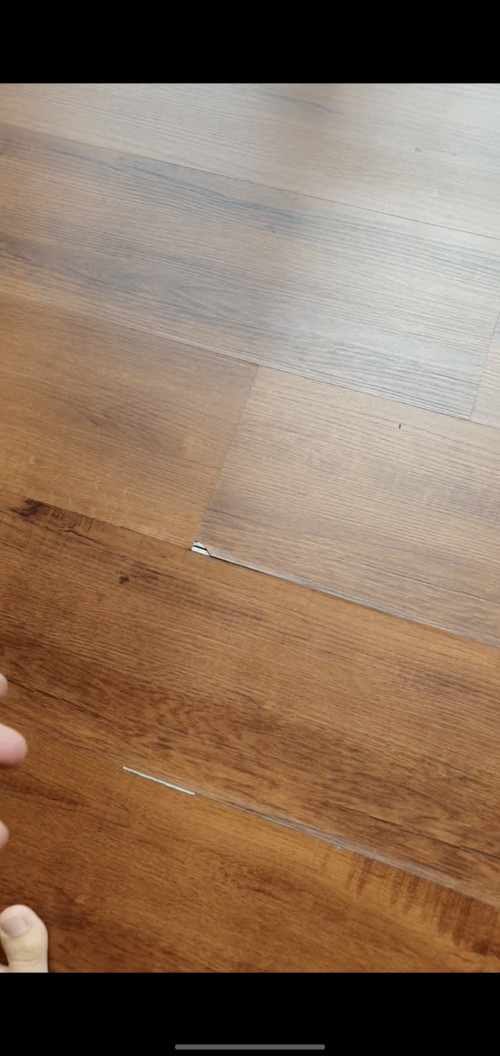

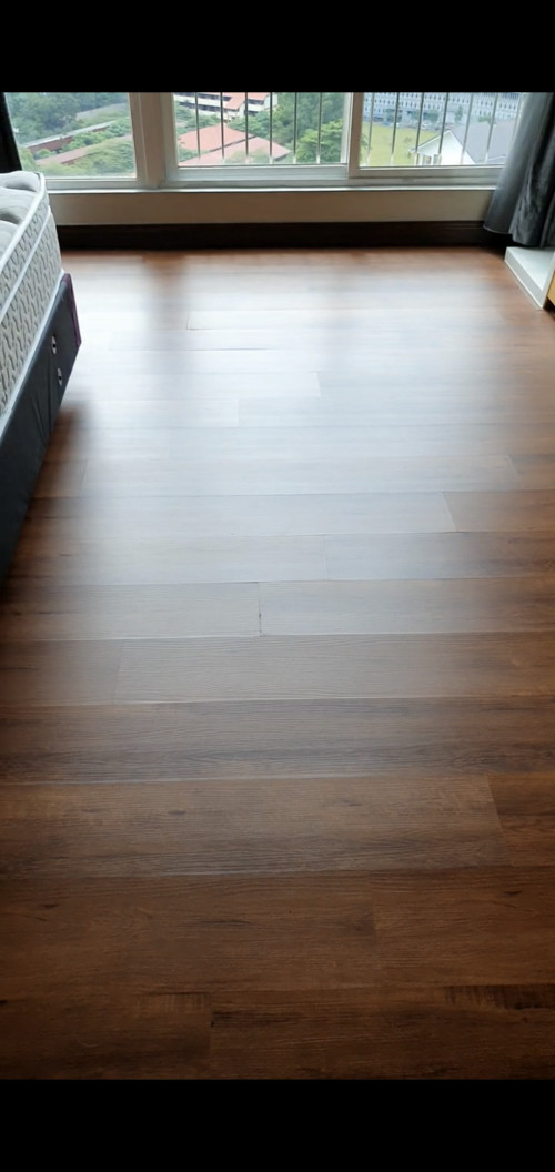

I would like to share my bad experience of installing SPC flooring with Floor World Cheras. There are a lot of flooring shops out there, I hope this sharing will help you guys to avoid those shops that only cost you money and troubles, one of them is this shop.
I had them install SPC flooring for my 300 sqr ft bedroom early last year. The price was RM 5 per sqr ft for 4+1 SPC flooring, made in Korea. The initial service was good, I was under impression that they had expertise on SPC flooring. Response was fast, installation arrangement went smooth, and I was a happy customer.
After the installation, that bedroom was empty for quite some time (the property is for rent, and there was no tenant during pandemic); during that period I did not notice any issue with the SPC flooring; a little over a year I had one tenant staying, and within one month the flooring was visibly warping quite badly and chipping off. I contacted the shop; they concluded that the SPC flooring had expanded but they were quite adamant saying that any SPC material is expected to expand so there was no material quality issue; they blamed me for not informing them when the expansion happened within the 1 year warranty period; they said SPC usually expands and "adjustments" are sometimes needed. To my defense, I am not an SPC flooring expert, it was difficult for me to identify whether expansion had happened and whether it was under normal tolerance or there was a problem. When I asked why I was not informed that SPC flooring might expand and adjustments might be needed (otherwise I could have been more careful in monitoring it), their answer was "we could not tell customers like that because it does not always happen". When I challenged them whether there was installation problem, their reply was "our installers are experienced".
The shop contacted their supplier to get some material compensation. As I don't want to wait that long, I asked them for a reasonable solution, however they came back to me quoting the same amount of cost like what I paid for the initial installation (but this time without any warranty!); they were not willing to share any responsibility to help solve my issue. The shop then told me that the supplier would be willing to get me material replacement if the moisture level in the room is below 8%; I do not know about this measurement, and whether this is the right threshold, at the end they came to do measurement on my subflooring; their reading was 15%, and they concluded that the room was too humid and there is nothing wrong with the material.
I then engaged 3 other flooring companies to do a site visit and they all shared the same conclusion that the issue was likely caused by
1) some humidity (the room was unoccupied for some time). My property is a condo unit on the 6th floor; the room was never under direct sun light
2) bad quality material where the SPC flooring easily expands. Before this I had laminate flooring in this bedroom for 10 years and there was no expansion issue due to humidity. One of the 3 flooring companies mentioned that for such a small area (300 sqr ft), they do not expect SPC flooring to expand that much.

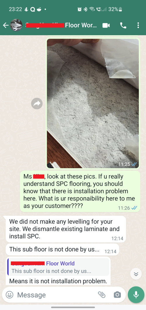

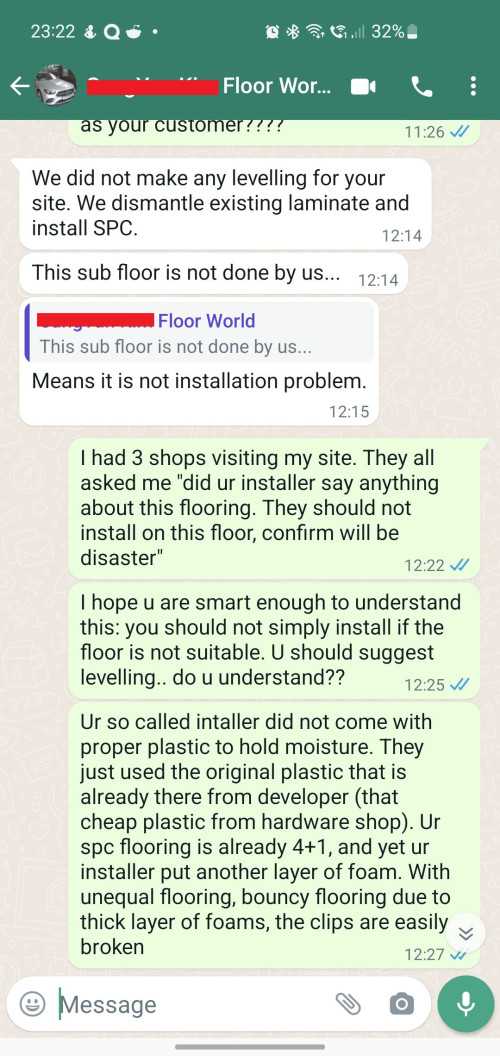

3) most importantly: wrong installation! All 3 flooring companies mentioned that the floor condition of my bedroom was not even and thus not suitable for direct installation of SPC flooring; floor leveling should have been recommended first before the SPC flooring installation, otherwise all the SPC flooring clips will be broken due to uneven surface (that was the reason once the room was occupied within 1 month the flooring was visibly warping and chipped off). Floor World installer also unnecessarily used 2 layers of foams, making it too thick and bouncy, and combined with uneven surface the SPC flooring became unstable and led to broken clips.
When I challenged the owner of Floor World on the floor leveling issue, she claimed that sub-flooring was not their responsibility, what they did was to remove my old laminate and install SPC flooring. That reply summarized it all: bad quality material, lack of expertise, and unwillingness to help solve customers issues. Think twice if you want to engage them.

Not with glue, it uses clipping mechanism. If the floor is not flat, if people step on it, the floor will move up and down and at the end break the clip. My SPC is also very bouncy coz they put 2 layers of foams, one already sticked on the SPC , and yet they add another foam layer on the floor, that makes the clips breaking even more.
I guess the shop knows that the subfloor is not suitable and they tried to work around it by just putting another layer of foam.
