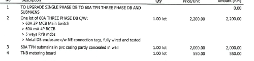

1) One lots of 60A three DB c/w :
i) 60A 3p mcb main switch,
ii) 60A 100mA 4p RCCB,
iii) 5ways RYB mcbs,
iv) Metal DB enclosure c/w NE connection tag, fully wired and tested.
Qty :1 lots
RM :2200.00
2)4c25mm2cu pvp submains in pvc casing partly concealed in wall.
(estimate 6m).
Qty :1 lots.
RM :2000.00
3)TNB metering board.
Qty :1 lots.
RM :550.00
Total :RM 47500.00
>TNB submission.
Qty :1 lots
RM:1500.00
Grand Total :6250.00
And also 2.2k for TNB change cable (kaki lima) ... and it tooks 2~3 months plus to complete.
