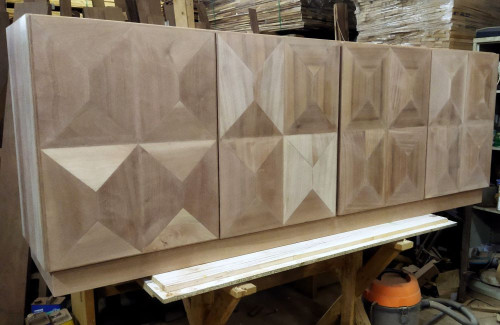

just completed a extra large 8ft solid wood sideboard with 3d geometric door details.
doors made using Sapele african mahagony.

Nice. CNC or all manually?
TSar188
post May 28 2022, 10:37 AM
9,206 posts
Joined: Jun 2006
QUOTE(Minolta @ May 27 2022, 11:33 PM)

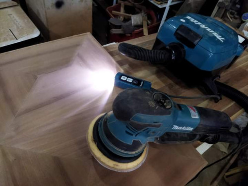

Curious what finishing are you using. The contrasting wood grain looks unique
TSar188
post May 29 2022, 07:15 PM
9,206 posts
Joined: Jun 2006
QUOTE(Minolta @ May 29 2022, 02:20 AM)
👏 how many hours labour total?
i think 1mth start to finish to do all 4 doors. from concept to idea on how to build, gather the sapele wood of specific size length n thickness, then maybe 1wks or 2days per door to cut n glue them in place. sanding the doors to a smooth transition between surface angles is another job on its own. and also sapele wood has alot of tearout (leaves surface withalot of pimple holes due to interlocking grain pattern) so we need to sand them so that the surface pimple holes are completely gone.
have to use a high end hand held sander +vac combo for best results.
the contrasting wood was not intentional. just being random at wood selection, some have darker tones, some are closer to the edge of the tree trunk...lighter wood tones.
overall not too bad outcome after doing some finishing
This post has been edited by ar188: May 29 2022, 07:15 PM

QUOTE(ar188 @ May 27 2022, 12:08 AM)
that panel is flat with visual 3D pattern right?
TSar188
post May 30 2022, 03:18 PM
9,206 posts
Joined: Jun 2006
QUOTE(Max @ May 30 2022, 02:30 PM)
the back of the panel is flat as its a door. the front pointed tip is protruded out 20mm, physically its 3d not 2d front face.
Did you sand away the pimple holes? Or CA glue/epoxy fill?
Again, nice work. Lotsa hours spent. Hopefully the owner will appreciate it.
TSar188
post May 30 2022, 11:56 PM
9,206 posts
Joined: Jun 2006
QUOTE(Minolta @ May 30 2022, 11:40 PM)
thanks!, yes owner is a regular customer, she ordered a few items before
as for the pimple holes, tearouts due to the grain of african mahagony being interweaved and when planing, tearouts happens when grains switch directions
yes have to sand away. looks ugly if use ca or epoxy.. unless its black walnut slab tables then it doesnt look that obvious and can use CA glue.
