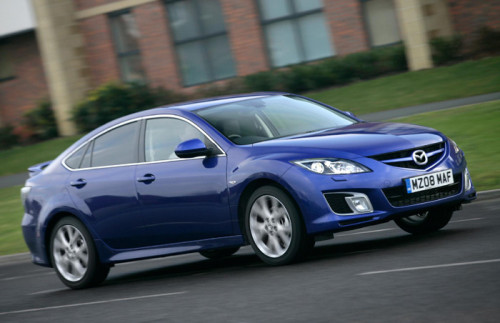

Hi guys, been searching for a car and found that mazda 6 is pretty cheap. Particularly the 2008 model. Apart from wear and tear, is there any common issues or problem with the car? Much appreciated

her electronics as reliable as Toyota & Honda ?
sensors easy kaput ?

earlier gen mazda 3 has problem with door lock mechanism causing it activate the alarm, and also it has problem with the AT sensor iinm, maybe mazda 6 will have the same problem as well, but these problems is not that expensive to be fix
earlier gen doesn't appreciate as good as the latest gen, and fuel consumption is bad on this 2.5L, while the power produced isn't as good as skyactiv 2.5, it has slightly better horsepower and torque than skyactiv 2.0

IINM, Sticky dashboard
