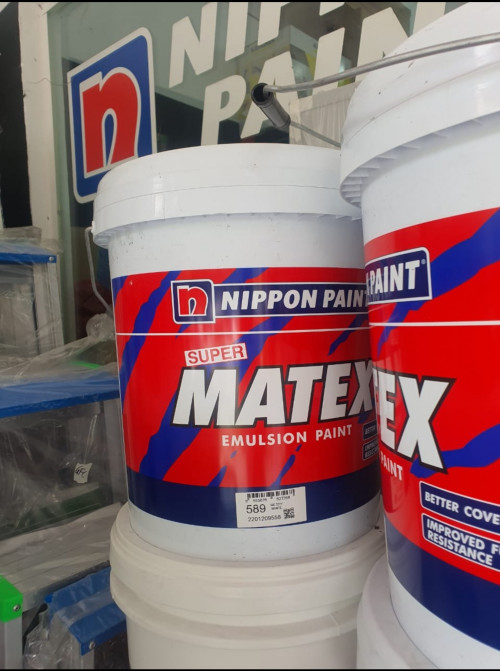

well normally i do not recommend skimping on paint quality as i want my paint to last very long.
its a big hassle to re-paint a room when you have furniture already.
but personally i would primer and then paint.
but among the choices above i would go for the nippon matex.

Brand preference only lah, Matex do not dilute with more than 2-3% water *be very kiamsiap with the water for best results*.
KCC more solids but harder to stir.. it dries thicker
Matex very beginner friendly, easy to apply, my personal preference
Jotun.. somehow I find their economy paint not as cheap so I never use

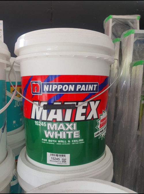

usually i just use the "White" one.. 15425 is ICI code for white IIRC.. both should be A4 paper white aka boring white, either is fine
