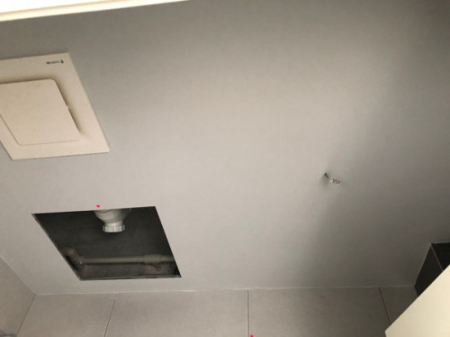

After reading all the comments here, I have a concern with my new unit now. shocking.gif
My master room's bathroom does not have a window, and the developer only provides a ceiling ventilation fan installed in the bathroom.
Is this acceptable? and is there any way I can do to improve air circulation in the bathroom?

Leave the bathroom door and room window open to improve ventilation

Check whether there is any duct that connect into it. If there is a duct, must likely it will vent to somewhere else.
