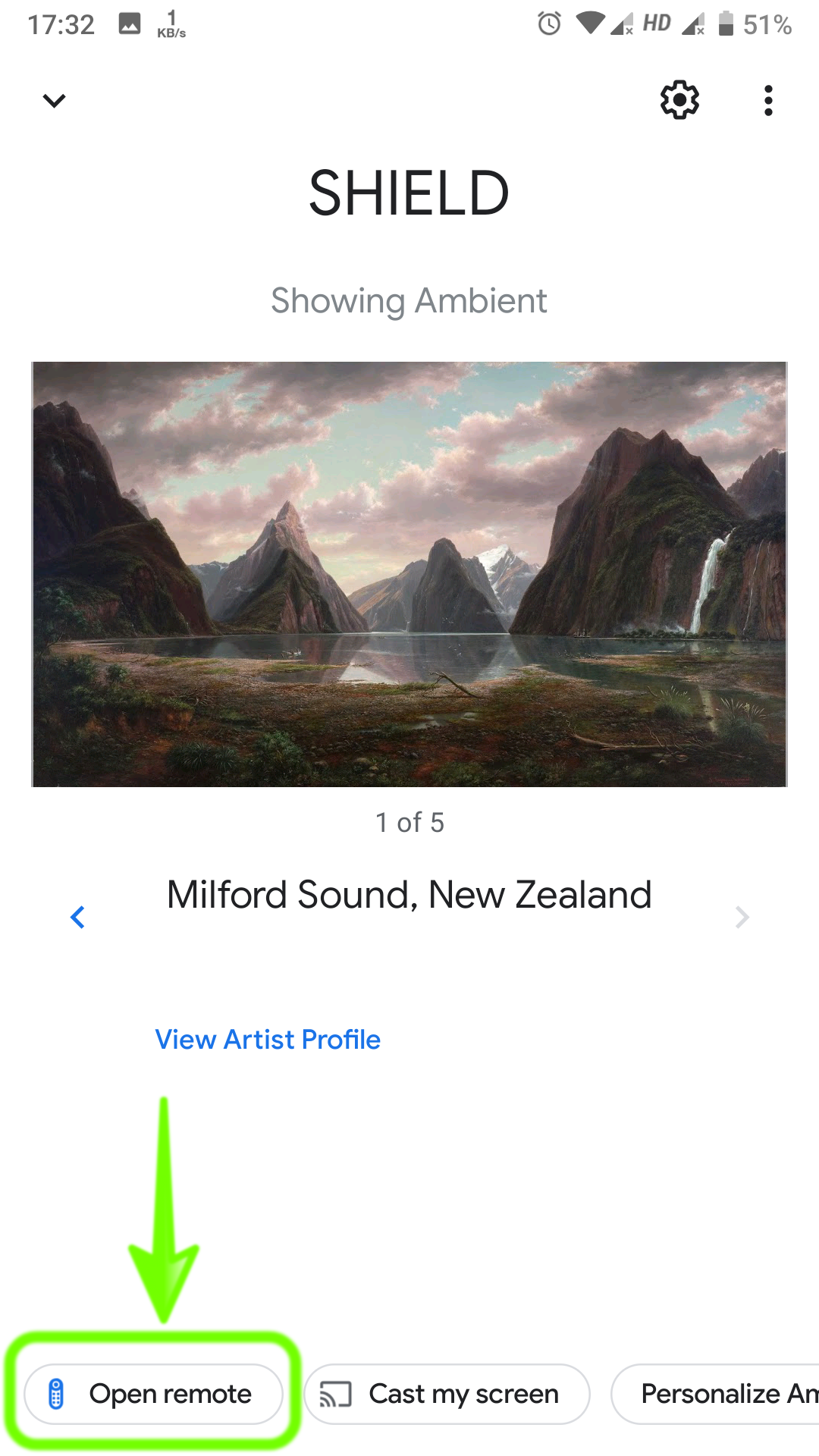

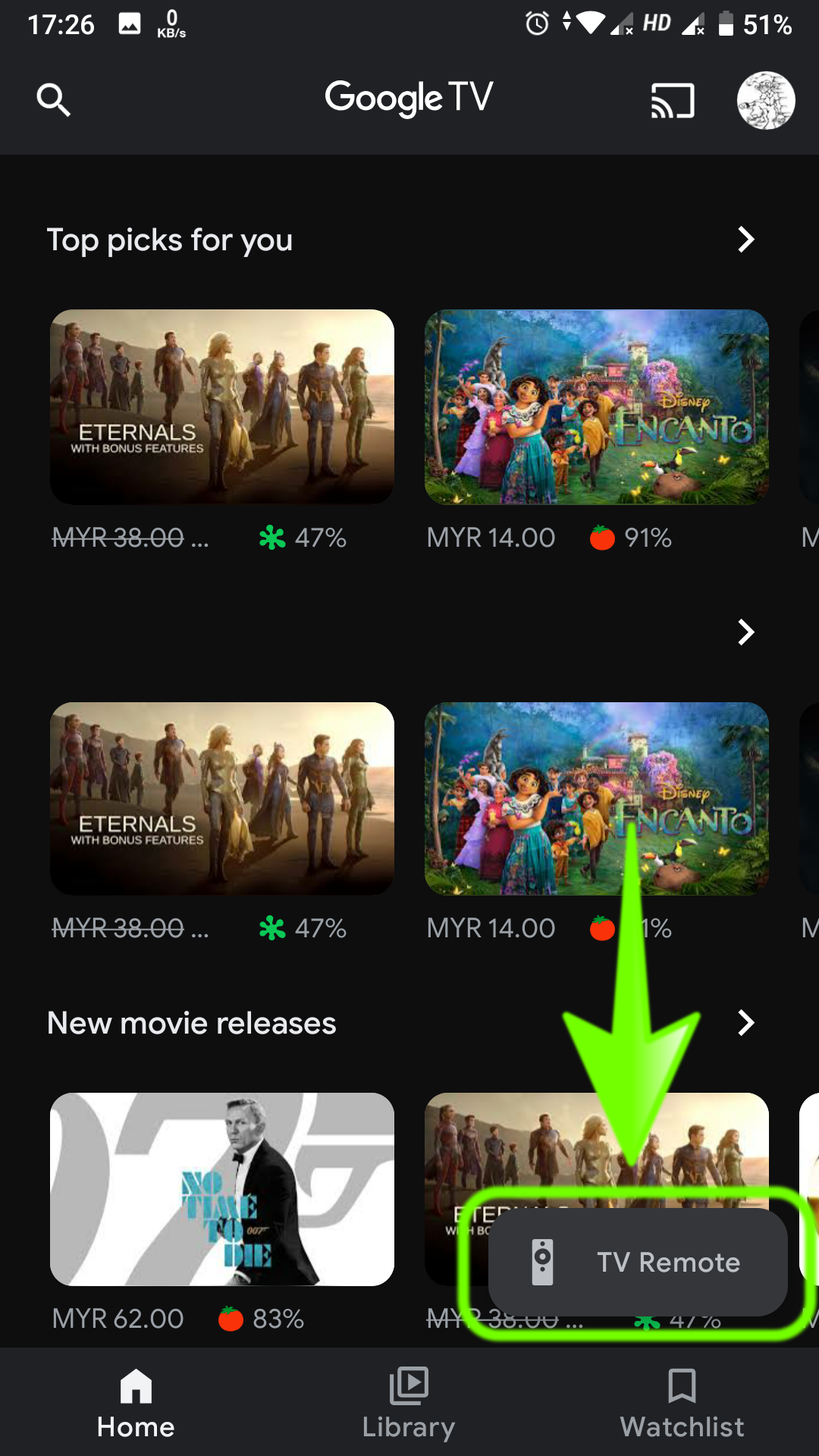

juzmafia
post Feb 28 2022, 06:08 PM
562 posts
Joined: Oct 2012
From: Out of the world...
QUOTE(wayton @ Feb 25 2022, 02:37 PM)
Just bought a new sharp aquos Android TV.
Everything work fine on the remote control, but when press the google assistant button on remote control, nothing comes out or any respond on TV
Already turn on the google assistance option on setting, but doesn't seem get it work.
What I missing in order to make the google assistance work?
QUOTE(wayton @ Feb 28 2022, 11:27 AM)
Go to the remote control option or bluetooth section, no remote control is paired. But I can use the remote control perfectly, just the google assistance.
Iinm, your remote has microphone so it will need to connect/pair in bluetooth mode to send voice command. If Bluetooth fail to connect then IR will work only with limited keys especially to navigate.
What model is your TV. Check the manual on how to pair in Bluetooth mode.
Maybe can try follow this video for Sharp TV but before doing that do cold boot and access the remote & accessories section before pairing so that you can monitor if the TV detects the remote.
Refer: https://m.youtube.com/watch?v=E9pv73B6S90
If still unsuccessful then try the remote app as suggested by RViN but the remote app that was mentioned in the post has stop working.
Now there is new Google remote feature and make sure all apps on your TV are up to date.
The new remote feature is available in the following apps:
1. Google TV(Link: Android)
a. Access from Quick Settings remote tile - https://m.imgur.com/a/OkfLvwM
b On app home page - https://pictr.com/images/2022/02/28/BAsfVV.png
2. Google Home(Link: Android, iPhone/iPad)
a. Access from device page - https://pictr.com/images/2022/02/28/BAsbEv.png
How to use the paired handphone as google assistance?
Afaik, it is not possible on Android TV unless manufacturer add the feature to the device to use external microphone which i don't think they are allowed to do.
Misread handphone as headphone..🤦‍♂️
Yes, it is possible to use phone mic for Google Assistant with the app remote feature as mentioned above via WiFi or Bluetooth(only with Google TV app and access the remote feature from Quick Settings remote tile).
Make sure to give location permission for Bluetooth pairing and allow microphone access for voice search.
