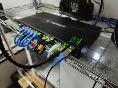

May 11 2024, 10:01 AM
#16
4 posts Joined: Mar 2011 |
QUOTE(Anime4000 @ Feb 9 2022, 09:53 PM) I have been using SFP xPON ONU Stick a year, result was very nice HiNo need Managed Switch, just plug into Router! More space saving! for Wi-Fi, I use TP-Link M5 (Mesh), more enterprise like networking in home I bought SFP xPON ONU Stick at taobao, then flashed V2801F firmware I have a tplink archer ge800 that has a sfp+ port for fiber connection My question is can i by pass the nokia modem provided by Allo service and connect it directly to the SFp + port on my router 2ndly how to configure it to by pass the nokia modem and cinnect ditecltly to my 10gbps sfp+ port in my tplink Kindly assist tq..attach is the router ![]() |
