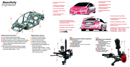

Since i am a pit crew, a lot of FD2 in MCS are not real FD2R, the chassis are from FD1/2. They only stripped the interior, installed rollcage, full bucketseat, modified K20 and gearbox with ratio plus full lock LSD etc. Then i look at the timing, a lot of them clocked an amazing time like 2:3x.
Question is, how does it really feels like driving the original FD2R vs the converted FD2R? I mean like really pushing the car instead of chill driving. And is it really worth it if i just buy a converted FD2R instead of the original FD2R?

chassis rigidity different bro..fd1/2 converted otr no roll cage. not like those mcs car ady..

I didn't dare drive my friends and mechanic/tuner customers FD2Rs.. scare anything happen i have to pay sweat.gif
An FD2R feels like a regular FD when driven at normal everyday speed. Even after tuning (properly done)
Pushing it was rclxm9.gif . Didn't have any friends with converted FD, so can't really comment.
But if done properly, should be just as good.

As a passenger, I find FD2R was much stiffer while normal FD1/2 were much more compliant and comfortable but I also never rode in converted ones yet. Of course wheels and suspension play a big part in the difference aside from the chassis stiffness.
I guess if the converted ones have enough additional chassis bracing and similar stiff suspension setup then they might also perform maybe up to 80% of the real FD2R. Whether that's goid enough for the money then up to the buyer.

If it was an FD, then can say it was converted to FD2R because they share the similar traits. However, converted Type R will never have the chassis rigidity of an original Type R.
Same goes for EK and FC.

chassis plays a huge role in lap times and especially for NA cars where you'll want to utilize those previous ponies effectively and efficiently

Wouldnt a stock FD2R vome with additional bracing/ chasis strengthening from factory 🤔
If add on full roll cage then maybe no difference, but if street version, i suppose will have some chassis stiffness difference, right ?

As per our friend here, the FD2R chassis are stiffer than the usual FD, so i guess the chassis have some spot or stitch weld from factory.
For full rollcage, depends on what kind of rollcage. If those cusco rollcage, i never drive them so i can't comment anything. But for those track use rollcage, the difference is obvious even for a non type r FD chassis.

But think again, the price for FD2R increased so much already, dug a big hole in my financial if i really getting the original FD2R...
QUOTE(Quazacolt @ Jan 21 2022, 11:24 AM)
Then save your time and effort and get a real type R
QUOTE(Napalm_man @ Jan 21 2022, 12:12 PM)
Lol i really want a test drive for the converted but i don't think i can feel the difference while cruising, and i also don't think it's a nice idea for me to praanggg the car while test drive. It's a gamble, i agreed with you that street driving won't be much different.
If you're serious about time attack then I agree with bro Quazacolt to just buy the real deal. Because at the end of the day, even if you manage good lap times in a Tipu R, there will always that lingering thoughts at the back of your mind asking whether you could've gone even quicker with the real thing. Hence you'd probably regret buying a Tipu R. Plus the pride and satisfaction of owning the real thing is irreplacable IMHO, that's why I also never interested in converted Evos no matter what.

QUOTE(Napalm_man @ Jan 21 2022, 10:22 AM)
Oh well, unfortunately i am the type that chasing seconds in track. Not really going for kanjo/touge anymore, sudah tua biggrin.gif
if you're gonna be chasing seconds, then get a proper cage..... that will settle the chassis flex if the cage is porperly built and anchored
another alternative is to stitch weld the chassis, but u gotta check if it's legal to do that..... u don't want to have problems later when selling off the car...... but no matter what you do, a proper cage is the best when it comes to chasing seconds
TSNapalm_man
post Jan 23 2022, 10:58 PM
723 posts
Rollcage 100% confirmed is illegal in Malaysia, but i always wonder how much is the cost for stitch weld? Heard some said if done super properly, the chassis would be almost like 95% type r.
Mysagavvt
post Jan 24 2022, 08:03 AM
45 posts
Joined: Jan 2022
QUOTE(Napalm_man @ Jan 23 2022, 11:00 PM)
That might also be illegal..... Chassis modifications are illegal according to jpj
TSNapalm_man
post Jan 24 2022, 08:42 AM
723 posts
Joined: Jan 2015
QUOTE(Mysagavvt @ Jan 24 2022, 08:03 AM)
But how do the JPJ know if we done stitch weld to our chassis? Since later the car will be covered by carpet UNLESS the owner want their car stripped naked like trackcar and daily drive it, which is super risky if you ask me...
Mysagavvt
post Jan 24 2022, 09:43 AM
45 posts
Joined: Jan 2022
QUOTE(Napalm_man @ Jan 24 2022, 08:42 AM)
u will have a problem at puspacom when u try to sell the car

I have owned a pre-FL FD2R & also a FL FD2R brand new from Honda Malaysia. Both taken to SIC, one on stock sussy, and the other on Ohlins.
I have also sat on fully converted FD with FD2R interiors and the legendary K20A at SIC.
There is no denying the rigidity difference between them. They are not the same, and I would say if the same driver were to drive a stock FD2R and a FD with converted K20A engine (no additional engine performance mods), his timing at SIC would be faster on the FD2R, even with the same tires and brakes. The steering correction at many of the sharper turns is reduced because of the rigidity.
There you have it, my experience with both.
Bro just curious, what do you think of FN2R? Price for DC5 seems to be sky rocket too, now over 120k even if direct owner.

Last time I got see what difference between FD and FDR in a magazine in kinokuniya. It's in Japanese. But lots of pictures that highlights differences. I remember the engine has polished intakes from factory. All the suspension is different. The control arms are also different. Running different camber also. The chassis has different reinforcement all round.

I think TS asking a converted FDR vs ori stock FDR
netmatrix
post Feb 10 2022, 02:36 PM
6,733 posts
From: Zion
QUOTE(ayamxxx @ Feb 10 2022, 02:33 PM)
Yes. So the things that cannot upgrade is chassis. I suspect the front lower assembly also different and not pnp.
