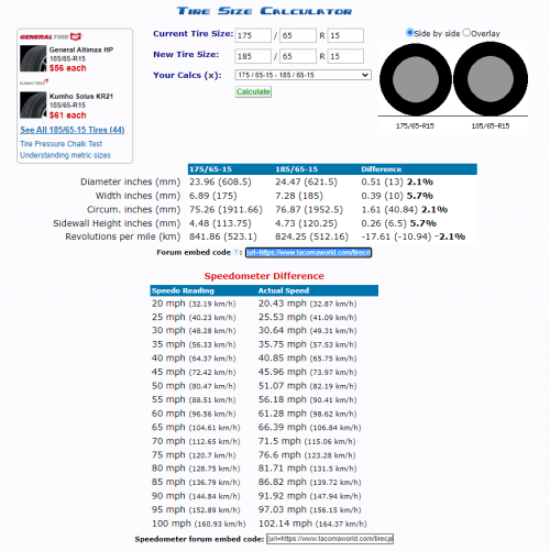

Mine ori 175/65/15 and change to 185/65/15.
i usually know the traffic police hotspot for speed trap. So i will using auto cruise to set at 90km/h so that avoid getting summon.
after changed to 185/65/15, i received a lot of summon for speeding at 93-95 km/h....
i wonder why did i got summon when i set 90km/j using auto cruise?
is it the diameter increase after changed to 185 ?
and why even over 3-5km/h also can get summon?
This post has been edited by taiko8148: Nov 21 2021, 02:54 PM

Cos your diameter is 2%+ bigger. Thus 90KM/h is like 92KM/h. To be safe, reduce it to 88KM/h.
Even tho the diameter in tyre side profile is the same, the overall circumference is increased due to the width.
Hope that helps.

If overall diameter of tyre within 2 or 3% with stick should be fine
The 175/185 is the thread patch width and 55/65 is the wall height ratio , the overall diameter need to calculate.
