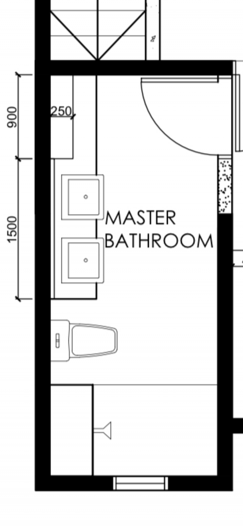

Picture 6 : layout of the bath area. Gonna go with one big basin instead of two as per the layout

post the layout here. it will give a better idea.
it there any wall on the left and right of the cabinet?

Edited post with layout plan. There is a brick wall on the R of the cabinets

You can do L slab as per your last pic before the layout plan. Make sure u ask the contractor do water proofing if it is cement slab.
You need to decide the finishing layer will raw or tiles. Not sure if you using stone. If using stone, make sure waterproofing the bottom layer of stone too before put on cement.
You also need to talk to your cabinet maker whether they ok or not; and how they want to mount.
Ask them show you excactly how to mount and get cement contractor to join the discussion.
Ask how is the water outlet is to be done, must get both understand.
How is the basin is place n mount.
Make sure the propose method allow you to change the water tap (basin cannot change is norm for these design).
Also, fyi the cabinet below basin is dummy. It is reserve for water trap.
Your table top is 2.5m, is doable with cement and reebar. Up to 3m still ok one.
