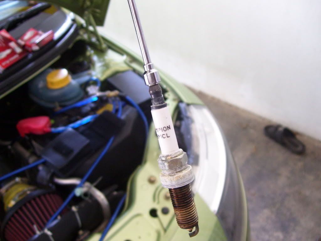

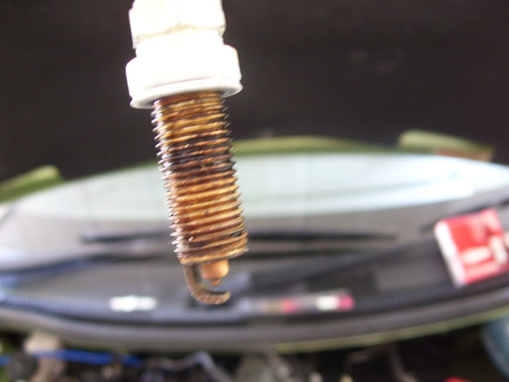

Added on September 11, 2007, 4:59 pmHere's my old spark plugs condition..
was having rough idling and occasionally misfiring..started to happen after heavy rain in Melaka and Batu Pahat last sinceFriday, Saturday..
Decided to change to new plugs - problem solved! No more rough idling..suspect it's water seeping from the weather seal at the edge of the bonnet, near the windscreen...it wasn't secured properly.
Some people said the white stuff is caused by water and rust of the lead (?)

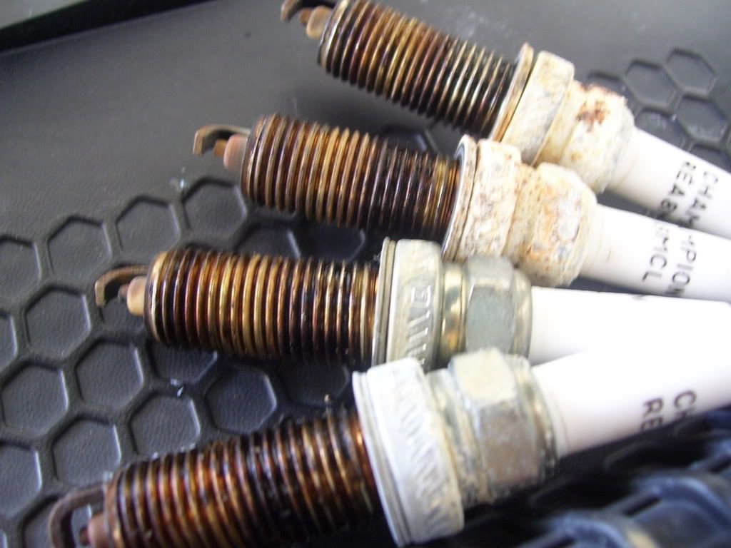

My old plugs from down to up (1-4)

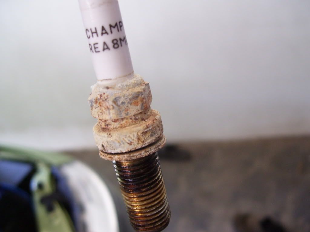

My 4th plug
1st plug

WTF those are the oxidization of your plug leads. your plugs how old?
i just swapped my factory plugs yesterday for iridium ones and while they've done 25k kms, they look only 10% as bad as yours save for slight carbon deposits (running rich).

Yes the champions caused my car to jerk when idle...lucky nothing serious. Car is ok when changed to new plugs. Ignition system is the main issue with Savvy..
What was the main cause of the oxidation actually? Is it water seeping into the hole? I dun remember having this prob with my old car.
The plugs done more than 40 000 km, 2 years old already...factory plugs..yes, it's rated to last 40k km in the manual.

oxidization happens when you drive fast in the rain and water splashes up on your engine cover or happens simply because water seeped in while you were washing your engine with water. 40k kms rated plugs not bad, but i'd change them sooner about 30kms as i can see your plug tips are quite eroded sweat.gif and the rust! laugh.gif

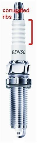

Wiki:By lengthening the surface between the high voltage terminal and the grounded metal case of the spark plug, the physical shape of the ribs functions to improve the electrical insulation and prevent electrical energy from leaking along the insulator surface from the terminal to the metal case. The disrupted and longer path makes the electricity encounter more resistance along the surface of the spark plug even in the presence of dirt and moisture.

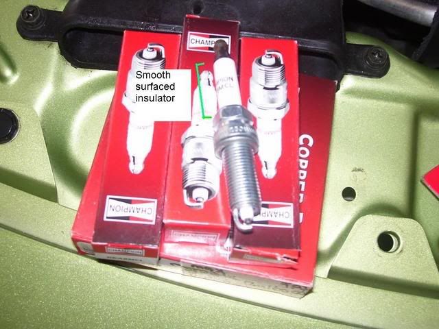

*Note: our stock Champion spark plugs' insulator only have smooth surface compare to other compatible Bosch, NGK and even Denso.
Champion plugs
Denso

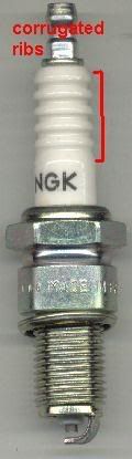

Not-for-savvy NGK plugs
Note the threaded part is shorter than ours, means Savvy's D4F engine head is very thick which is a good thing.
