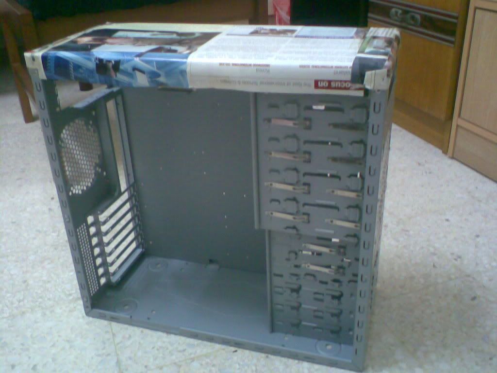

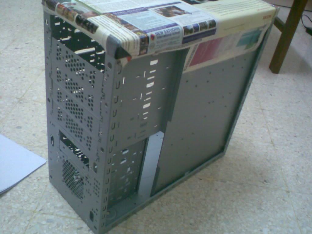

i already remove all unnessary thing .. it look like this
what to do next ??????????did i need to sand it and put a primer layer ? that is a must ?for flat black
This post has been edited by sheahann: Sep 11 2007, 10:32 PM

Dude,do you have a drill...? you can drill the rivets and take off piece by piece..

that 1 i think i can use my hand to pluck it off easily ....
what to do next ? i mean after i take those rivets out
Added on September 12, 2007, 12:14 am@
what i need to do to get a nice paint job ? it look difficult to spray EVEN to whole casing .. there is part by part which i need to spray accordingly .. so , which part i must start from ? that 5 DVD bay and HDD area ? or the mobo area ? or other part?
This post has been edited by sheahann: Sep 12 2007, 12:14 AM

QUOTE(sheahann @ Sep 12 2007, 12:11 AM)
Here we go dude,take out all the rivets,take them into pieces,then you can separate your your mobo tray,hard disk and cd rom bay,top,bottom and rear plate..
Then,you can go on with sanding down the factory color..
Then you can go on to spray...

QUOTE(ocz @ Sep 12 2007, 05:19 AM)
dats wut i mean..to get a good paint result u hav to dissemble all tho case part..not only drive bay.. n paint it one by one..but u need drill to remove the rivets and rivetter/small screw to assemble ur case back dude..
