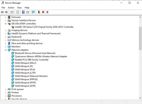

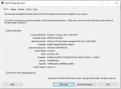

guys, need your expert advice.
im using ASUS GL752V laptop for years already.
anyone can help or have knowledge to upgrade the WiFi adapter to latest one which can support 5GHz?
Detail as below:

try troubleshoot the problem first, could be you need to update the driver for it.
also check online for other methods, like here's one:
https://www.reddit.com/r/AMDLaptops/comment...e=pocket_mylist

I think you can only install AC wifi card, support up to 5GHz

you may upgrade to Intel AX200
Intel® Wi-Fi 6 AX200 (Gig+), 2230, 2x2 AX+BT, vPro®
Ordering Code AX200.NGWG
Recommended Customer Price USD$16.00
https://ark.intel.com/content/www/us/en/ark...-ax200-gig.html

Make sure to buy the correct card format.
Some older ones (intel 7xxx series and below) is half mini card (HMC) and newer ones from 82xx intel series onwards use mini PCIE.
