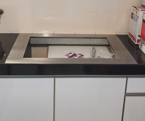

Hi folks,
I'm looking to buy a gas hob for my kitchen in my new place.
Cutout size -> 43x71.5cm (with stainless steel frame) / 47.5x83.8cm (original size)
I believe the owner purchase the stainless steel frame to get a smaller hob (the original hole is pretty wide!).
My question is, what size of a hob must I purchase to fit the stainless steel frame? Must the top of the hob completely cover the stainless steel frame?
Also, with a stainless steel frame, is it a must to buy a stainless steel gas hob? Will it be okay to buy a tempered glass gas hob?
Thanks!
This post has been edited by contestchris: Jul 3 2021, 08:52 PM

Any hob that can fit will do.
Most newer model have wide top plate but small internal so they can fit most cut out.
Go for highest watt if you can affort.

Smaller size.
A tempered glass will give the hob with a border appearance.
If the hob need to cover the stainless steel frame, then the frame doesnt serve its purpose and just buy the bigger size hob and remove the frame.

TScontestchris
post Jul 6 2021, 02:55 AM
5,582 posts
Joined: Aug 2011
Guys I'm still unclear about the size.
See my cutout (without the stainless steel frame) below.
It measures 83cm (length) x 47cm (width).
Must I get one with the EXACT SAME cutout?
Obviously the top measurements has to exceeded the countertop cutout (else it won't sit), but I'm really confused by the bottom cutout of the hob.
Some hobs seem to have a fixed cutout. Some flexible.
Please help me here.
Thanks!
