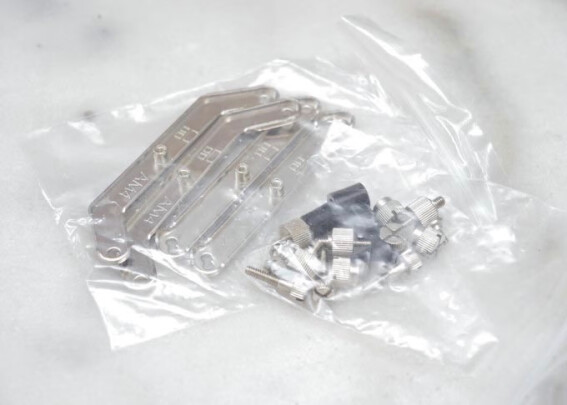

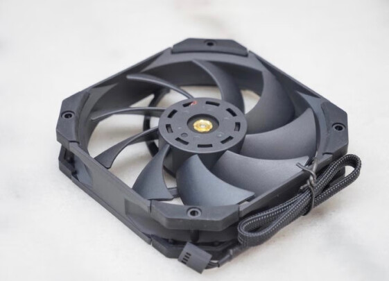

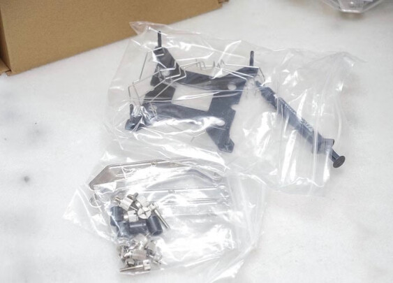

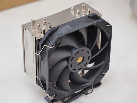

best cpu air cooler for 8940 i guess is soon to be launched thermalright silver soul 135, current available model should be thermalright tr-ta120 ex mini, thermalright ak120 mini, thermalright ts120 mini and it seems plug n' play out of the box.
link to purchase
https://detail.tmall.com/item.htm?spm=a230r...id=624008109286
This post has been edited by BOTAK_WAI: Aug 1 2021, 12:14 AM

QUOTE(BOTAK_WAI @ Jul 30 2021, 07:05 AM)
link to purchase
Just asking, have you used this on xps 8940, and how much temps have dropped compared to Noctua?
