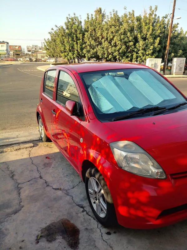

I have a 2006 Daihatsu Sirion 1000cc which is the same car with Toyota Passo, Subary Justy and Perodua Myvi. Since this is a popular car in the Asian market I would like to buy some parts that are only available in Malaysia.

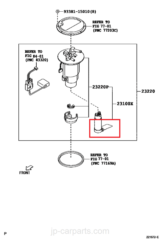

But both online stores don't sell the fuel filter separately but only as part of the whole fuel assembly which is very expensive and I don't need it since there is nothing wrong with the car.

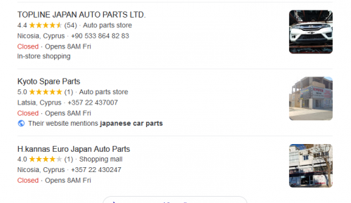

Thank you for your quick reply. I have already searched online and locally and I can find ONLY the whole fuel assembly which costs very much and I don't really need it

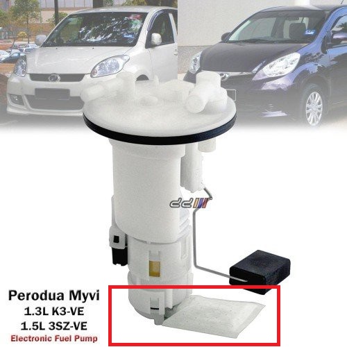

Also the one you highlighted is called a fuel sock/in tank fuel filter/fuel strainer. It a generic part that shared with alot of toyota lower CC cars
Denso 952-0006
https://www.ebay.com/itm/190676706787?epid=...JoAAOSwn9VacEcl
try give em a call on it

Hello thank you for trying to help the part for the fuel pump is:
Toyota, Daihatsu 23100B1030 from 357.66 EUR
Subaru 23100B1030 from 320.66 EUR
You can also see it from the previously attached photos.

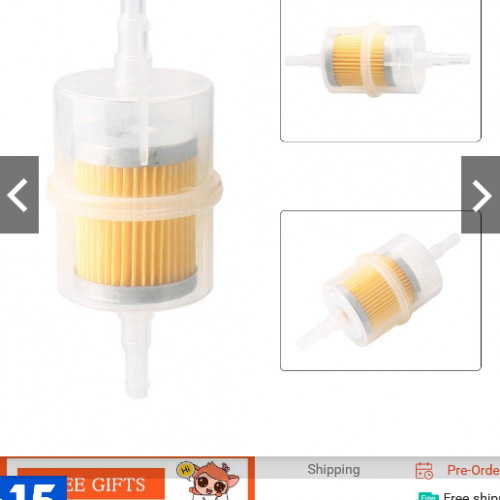

Also I have attached a photo showing how to filter is supposed to look like
I have found the part from Malaysian website but its after market and they don't list a product number not they send abroad.

Hi, you can try sourcing for the pump unit itself instead of whole assembly. It should come with the filter
https://shopee.com.my/product/273807120/394...10-1623952706.9
The pump unit is only 10 usd
You need to chat with the sellers and ask them if they can ship to cyprus.
