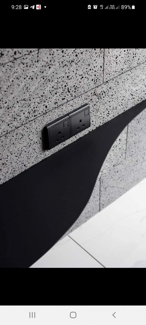

If you know the material or where to buy do comment below please. Many thanks for your kindness.
Anyone know what material is this?

Wallpaper?

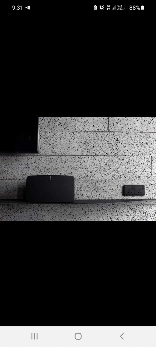

wow sonos 5.. i wanted that. but i can afford sonos 1 only. Sigh
https://www.lazada.com.my/products/schneide...i411968536.html - the plug seem scheneider peino black. Im using it now.. very bad quality. https://www.lazada.com.my/products/pre-orde...sQqkVY&search=1 - Sonos 5 This post has been edited by timeonce: Jun 9 2021, 10:09 AM |

Tiles with fine 'pebbles' surface finishing

QUOTE(timeonce @ Jun 9 2021, 10:08 AM) wow sonos 5.. i wanted that. but i can afford sonos 1 only. Sigh Sorry. I'm actually asking the board on wall. Hahahttps://www.lazada.com.my/products/schneide...i411968536.html - the plug seem scheneider peino black. Im using it now.. very bad quality. https://www.lazada.com.my/products/pre-orde...sQqkVY&search=1 - Sonos 5 |

https://www.suzuka.com.my/wp-content/upload...-catalog-E3.pdf
https://www.suzuka.com.my/wp-content/upload...g-E1.1-2104.pdf Can see this catalog. Think the lighting show like this. but should use material like suzuka i think. |

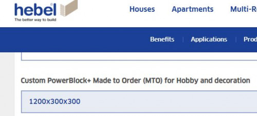

Jun 9 2021, 10:55 AM

Jun 9 2021, 10:59 AM

look like skinrock

Judging from the air bubble holes it looks like Autoclaved Aerated Concrete (AAC). Local AAC brands don't have this long format, unless customised or use their lintel (with embedded bars thus more expensive). Standard block length 600mm. Thickness varies 50-300mm. If you wanna use thinnest block to stick on wall as decoration you lose 50mm wall thickness.
Local brands such as Starken, Alamcon, Greencon Overseas brand such as Hebel ![]() |

544 posts Joined: Mar 2013 |
QUOTE(Phyarc @ Jun 9 2021, 11:58 AM) Judging from the air bubble holes it looks like Autoclaved Aerated Concrete (AAC). Local AAC brands don't have this long format, unless customised or use their lintel (with embedded bars thus more expensive). Standard block length 600mm. Thickness varies 50-300mm. If you wanna use thinnest block to stick on wall as decoration you lose 50mm wall thickness. Thanks. Will check it out. 50mm is really thick lolLocal brands such as Starken, Alamcon, Greencon Overseas brand such as Hebel ![]() |

I would expect this is one of those 3d wall stickers.
Not exactly the same design but similar type: https://www.lazada.com.my/products/ver-bloc...8435908453.html https://www.lazada.com.my/products/ready-st...8130523494.html |

153 posts Joined: Apr 2019 |
QUOTE(tky1993 @ Jun 9 2021, 12:33 PM) lol. bcos it's meant for wall than finishing.This could be customised product or rare stone finish. Hard to get exact finish. By the way, it looks full body and not printed...see the edge also have black dots. Your alternative options:- 1. AAC - more white and smaller bubbles. May not get same look. 2. Sukuza - didn't have such finish, but other texture 3. Tiles with print of similar finish (see attachment) 4. Vinyl sheet with print of similar finish Attached File(s)

I doubt such block, if is 'real' are used in highrise unless done by developers.
For landed, detached, semi and corner terrace may have it and I doubt is cheap. |
QUOTE(Phyarc @ Jun 9 2021, 02:41 PM) lol. bcos it's meant for wall than finishing. Thanks alot. The tiles look similar but not sure if it's hollow like in my picture. The reno firm is based in malaysia, was really curious where they got such finishes.This could be customised product or rare stone finish. Hard to get exact finish. By the way, it looks full body and not printed...see the edge also have black dots. Your alternative options:- 1. AAC - more white and smaller bubbles. May not get same look. 2. Sukuza - didn't have such finish, but other texture 3. Tiles with print of similar finish (see attachment) 4. Vinyl sheet with print of similar finish This post has been edited by tky1993: Jun 9 2021, 02:50 PM |

QUOTE(tky1993 @ Jun 9 2021, 02:50 PM) Thanks alot. The tiles look similar but not sure if it's hollow like in my picture. The reno firm is based in malaysia, was really curious where they got such finishes. I doubt hollow block can have strong support for the tv.The stscking of each block is so neat with fine line ...using glue perhaps if is real block ? This post has been edited by mini orchard: Jun 9 2021, 02:59 PM |
