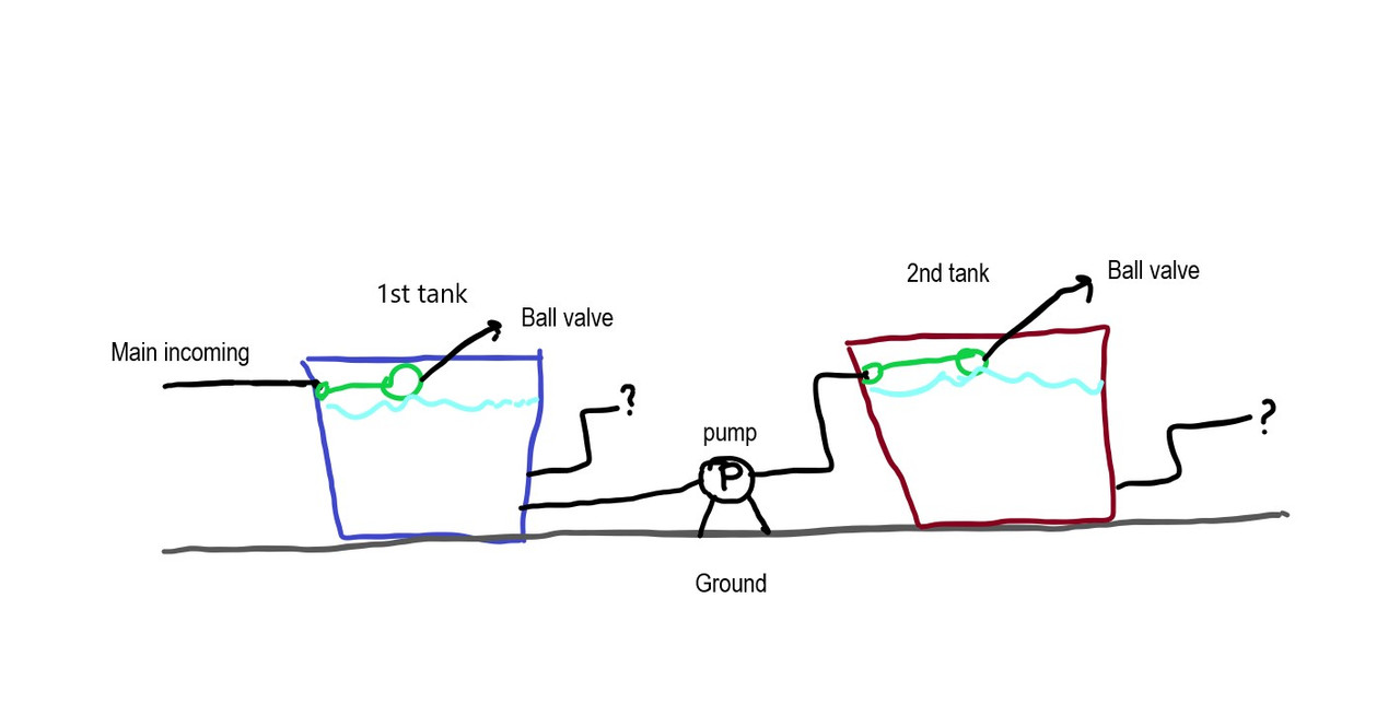

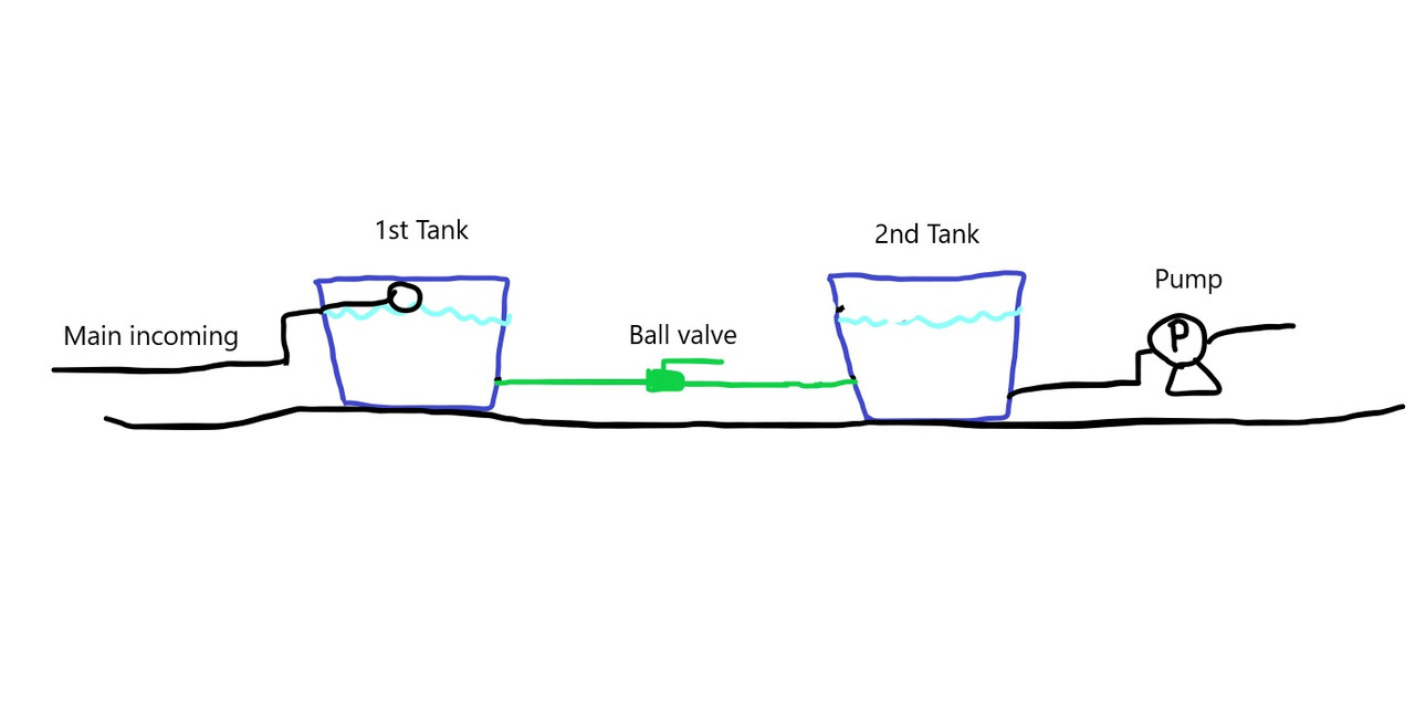

ozak
post May 17 2021, 03:51 PM
10k Club
17,024 posts
Joined: Jan 2005
QUOTE(mini orchard @ May 17 2021, 03:10 PM)
At first I was also confuse .... water, light, off pump.
The reserve water tank is to store water from the main and to be pump to the various part of the house.
In most houses, water from the main is faster or equal to uage but not in ts case .....
Incoming flow from the main is slower than usage ... hence need to turn off the pump b4 the water dries up to prevent the pump from damage.
He mention that the pump is from the secondary water tank.
So it pump the water out from the tank?
In this case, why not join a pipe between 2 tank to equalize the water on both tank?
With this, no need sensor or anything. Gravity take care everything.

ozak
post May 17 2021, 05:35 PM
10k Club
17,024 posts
Joined: Jan 2005
QUOTE(ceo684 @ May 17 2021, 05:08 PM)
The core idea is the tank is used as feed tank. Feed tank must not run dry. If got water then it is safe to run pump.
Not used as filler tank so we cannot use fill control type for aquarium that stops when at Hi level.
I have 2 tank also. What I do is not let the tank dry or water not in usage at all.
And didn't use any electronic or electrical to control. Just plumbing and gravity.
I think ts 2 tanks are not on same level.....one grd flr, the other higher. Gr supply water to higher. Main supply is weak to supply to higher, hence the grd fl tank with pump.
SUSceo684
post May 17 2021, 07:36 PM
Component Burner
11,667 posts
From: Klang/Subang
QUOTE(mini orchard @ May 17 2021, 05:57 PM)
Yup, hence to prevent feed tank pump from running dry, my suggestion was just use a Lo level sensor to operate contactor to power pump (allow pump to operate) ONLY if there is water beyond a Lo level at feed tank. So he dont need to risk going out in the darkness (snakes or bugs) at night just to check the level manually. If there is enough water inside the feed tank then the contactor will be able to supply power to his pump (or smart switch if he wants to on/off the pump manually on demand).
Hi/overflow of the feed tank no need to bother as that is already automated by the float.
This post has been edited by ceo684: May 17 2021, 07:37 PM
TSmystvearn
post May 17 2021, 10:22 PM
6,639 posts
From: "New Castle"
QUOTE(ozak @ May 17 2021, 02:40 PM)
"Only when the water level is empty, I need to cut it out in order to protect the hitachi pump. "
Sorry I m confuse.
The water pump is pumping the water into the tank ?
Or pumping out from the tank?
My house area water pressure from main is slow. Very slow. Weekday from 10 am - 10 pm no water. Hence there is a table next to the main pipe for catchments from 10 pm onwards. There is another tank at back of the house. Between the first and second tank, there is a pump I cannot let the pump run all the time as sometimes the water from the front tank gets empty. So I need a mechanism to cure off water when it is empty
