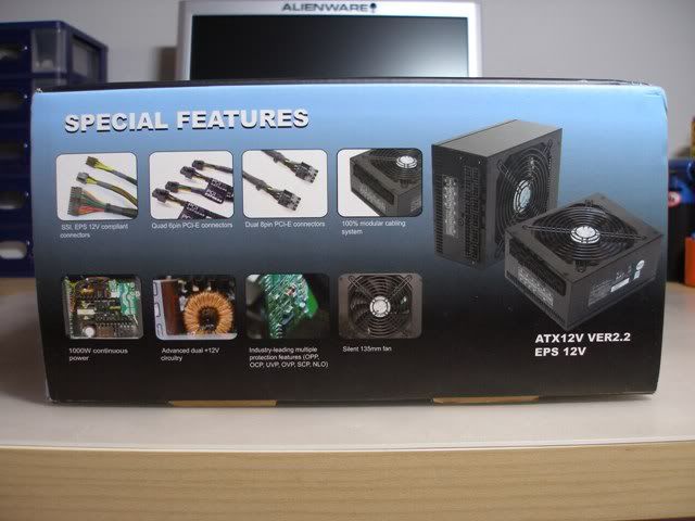

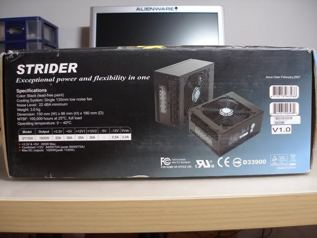

What you see here is the retail package. It comes in a big box. Very well packed and protected. There are some really thick foam blocks that keep the PSU sitting snugly in the box to prevent damage during transportation. I've also included a standard ATX PSU(OP750W) in the picture so you can compare the size. The ST1000 is only slightly bigger than the OP750. The ST1000 is compact, but still very heavy. It's listed as 3.0kg. Small cases will have no issues with this PSU. There's some good news here for friends of the planet. The black paint used on the PSU case is lead free paint and the PSU itself also RoHS compliant.

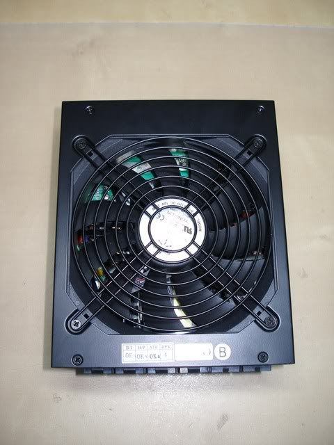

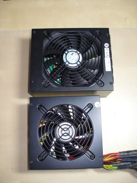

Here is the top of the ST1000. It uses a single 135mm fan. Silverstone rates the fan noise as 22dBA minimum. From my trials, the fan can't be heard over the rig's system fans so it's nice n quiet. Though Silverstone has packed a very powerful PSU into a small, compact case, they've managed to keep the unit cool and quiet.

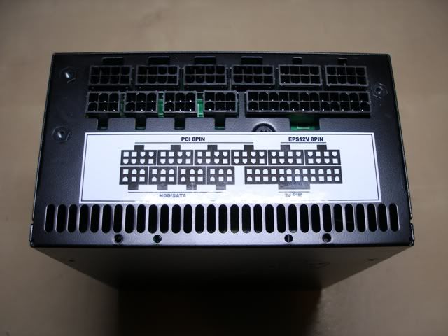

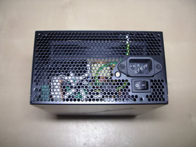

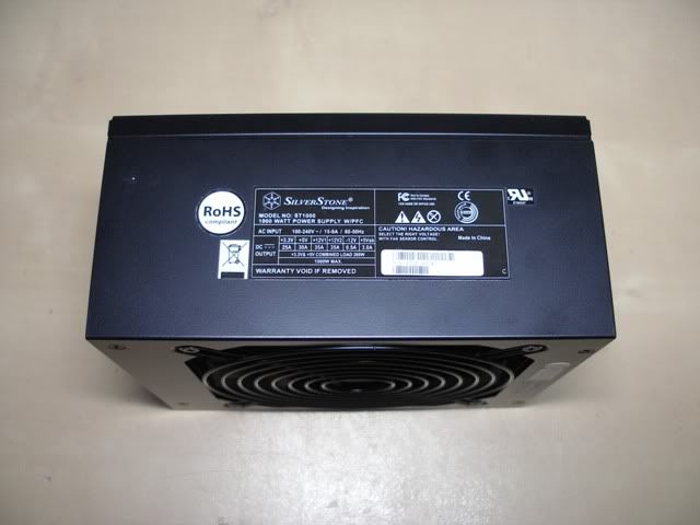

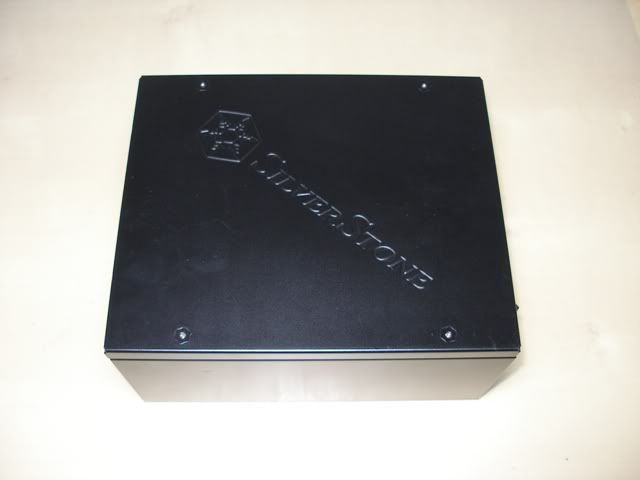

Here's how it looks like on the bottom, rear and side of the PSU.

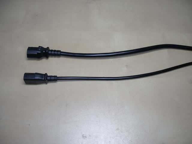

The power connector wire is now of the normal type. It's no longer the proprietary pin type like the OP1000. The wire is much thicker than normal PSUs though as can be seen in the picture above. It's good to know that the wire can handle everything we throw at it. I wouldn't trust the normal puny wires on a 1000W PSU.

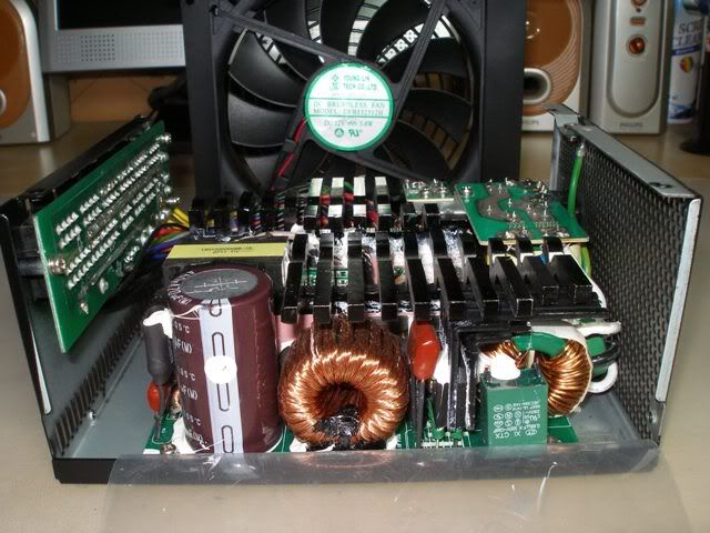

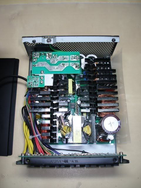

Poast internal pics.
But i'm betting this is a full bridge forward PSU.

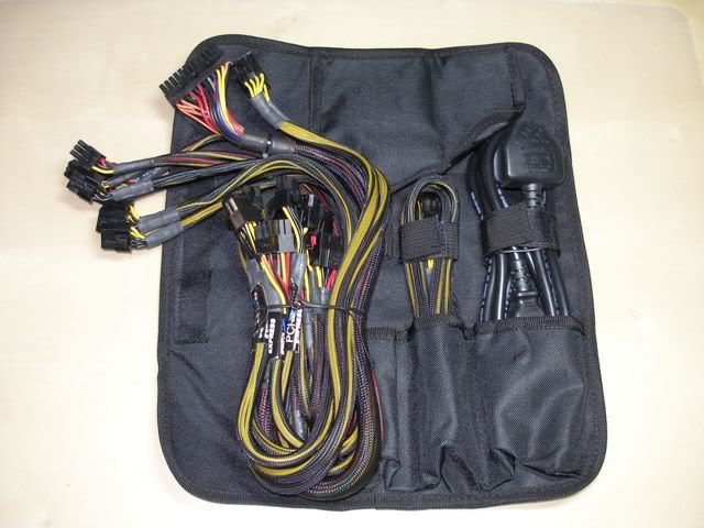

The ST1000 comes with a whole bunch of wires and they're modular as can be seen in the picture above. All necessary wires are already plugged into the PSU including 2x8 pin PCIe plugs. There's 2 more 6 pin PCIe plugs in the bag for those running 2x 8800GTX which requires 4x 6 pin PCIe plugs. The 2x 8 pin PCIe plugs are for ATi Crossfire. I removed the 2x 8 pin plugs and installed 4x 6 pin plugs as I will be testing with 8800GTX SLi.
The ST1000 comes with the following plugs:
1 x 24-pin motherboard connector (550mm)
2 x 8-pin EPS12V connector (550mm)
1 x 4-pin ATX12V connector (550mm)
2 x 8-pin PCI-E connector (550mm)
4 x 6-pin PCI-E connector (550mm)
2 x triple SATA connector (500mm +250mm + 250mm)
2 x triple 4-pin IDE & single floppy power connectors
(500mm + 250mm + 250mm + 150mm)
Take note that the ST1000 is fully sleeved now. The previous OP1000 and OP750 sleeves only go up to the 1st plug of the SATA and molex plugs. I put that down as a negative point in the OP1000 n OP750 reviews. Looks like Silverstone finally took our suggestions and have now implemented full sleeves on all wires. Big thumbs up to Silverstone for listening to the customer's needs.
Here's the PSU with all the wires taken off. It comes with a nice bag for you to store all the unused wires.
The PSU is very well built. It isn't as nice as the Olympia series though. It's also made in China as compared to the Olympias which are made in Silverstone's new robotic factory in Taiwan. The components and build quality is of a lower level. This is unavoidable due to the lower price point of the Strider series. However, the components used are good and more than enough for enthusiasts on a budget. Just look at the size of the heatsinks, capacitors and coils. Nice fat stuff for fat loads.

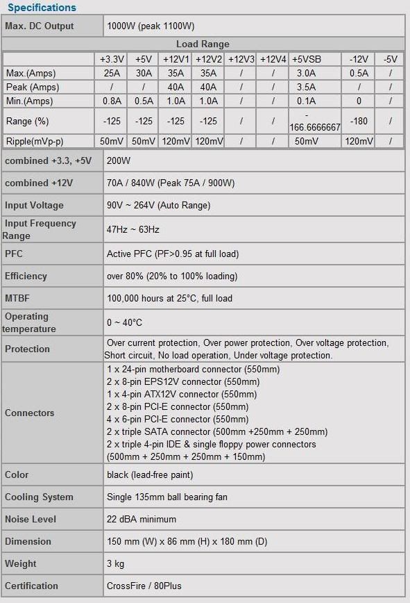

Here's the specifications sheet taken from Silverstone's site.

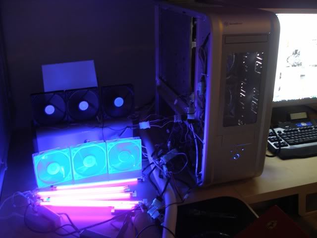

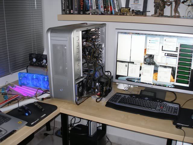

That's the test rig in the pictures above. Just to make sure I torture the PSU to the maximum I added in 6 more 120mm fans and 5 sticks of CCFL lights! Can you imagine any rig running with 8x120mm fans, 2x90mm fans, 5 sticks of lights? I doubt anyone would have all that in a rig. Heh.
Test rig's specifications:-
AMD X2 4200+ OC to 2.6ghz @ 1.6V
Arctic Cooling Freezer64 Pro HSF
Asus A8N32SLi Deluxe Motherboard
2x 8800GTX in SLI config. OC to 600/2000
2x1gb Team Xtreem Cronus OC to 520mhz @ 2.9V
150Gb Western Digital Raptor
250Gb Western Digital Caviar
Panasonic SATA DVD drive
8x 120mm fans
2x 90mm fans
5 tubes of CCFL lights

OP1000 vs ST1000? i'd go for OP1000, why?
- stronger 3.3V Rail (OP1000 30A; ST1000 25A), 5V Rail (OP1000 40A; ST1000 30A) and 12V Rail (OP1000 80A; ST1000 70A) - again, a single rail is better
- the heavier the PSU, the better... OP1000 weighs 3.6kg, while ST1000 3.0kg
- OP1000's operating temperature @50°C, 10°C higher than ST1000
on top of that... OP offers non-modular, single rail PSU thumbup.gif, about this ST1000, i didn't say it's not good, it's just my personal POV, that's all... smile.gif
