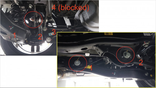

1) This is Elantra Sport multilink. The non sport version has torsion beam and full size spare tires, while the Sport have space saver because the multilink taken more space.
This is typical multilink on the econobox chassis adapted to sport sedan, 4 arms (1 of them is trailing arm). Civic has same design. Again, not all multilinks are created equal, this of course has less degree of freedom vs the 5 fully adjustable links on a pure sport car
As you can see only arm 1 and arm 2 are adjustable. They both affect toe and camber. So this depends of the experiences of the tire shop to balance the 2 arms.
Arm 4 is blocked in this view, and non adjustable. But you may in theory replace it with an aftermarket adjustable rod. Same for double wishbone, the A shape arm can be replaced with 2 adjustable rod (in modern BMW, the A of lower arm has become 2 separated arms). I don't know torsion beam has the luxury, or is it even possible?

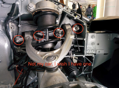

3) 488 Front upper arm of the double wishbone, bottom have same design. You can see the whole pivot structure is bolted, adding washer will move it away from the chassis, thus changing the camber, so it is matter number of washer at upper vs lower. Most passenger cars, the pivot points are part of the chassis, we can not do the same hack.
P/S: Borrowing this idea, how is the wheel bearing mounted on the torsion beam. Any potential to add washer? I don't know, hahaha
